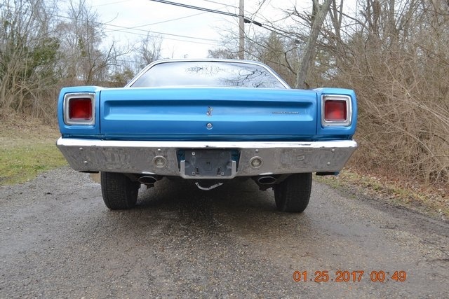

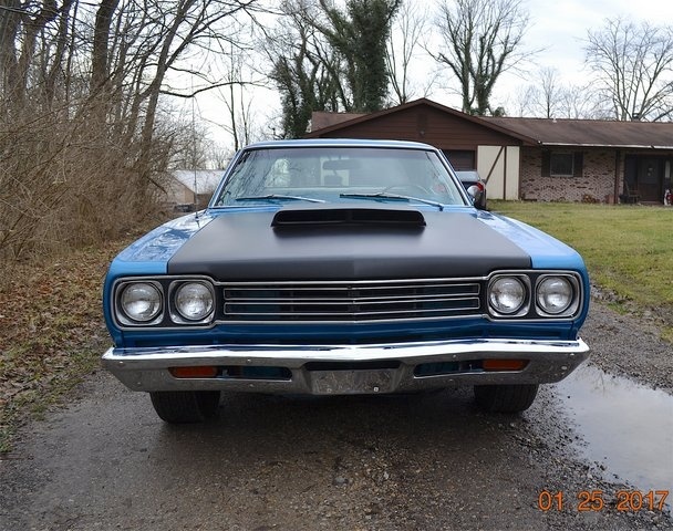

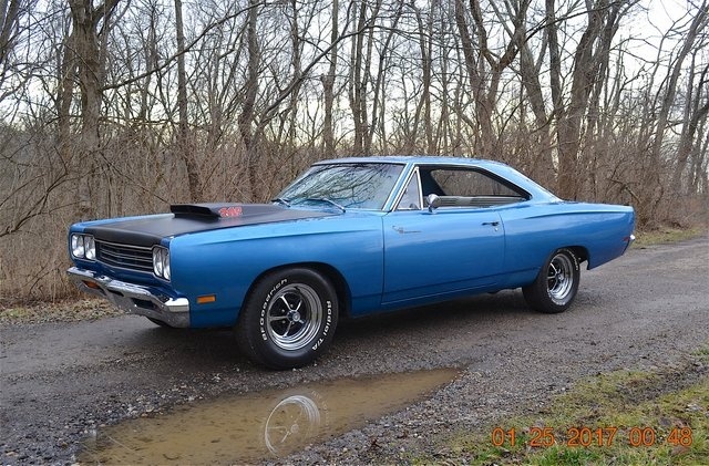

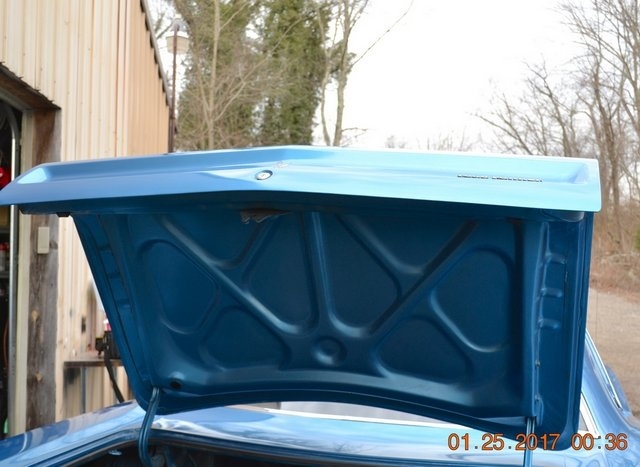

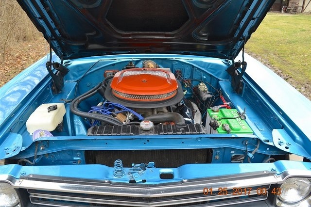

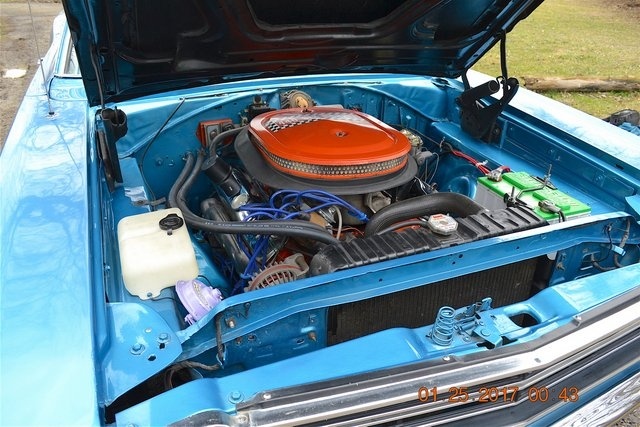

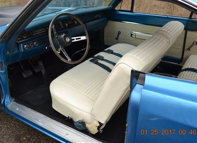

Nice 69 RR

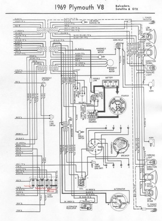

starter relay, wires, bulkhead connections, grounds, ignition switch
I'd start at the starter & go backwards
