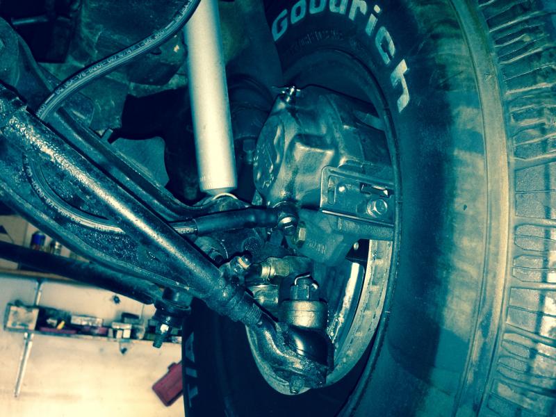

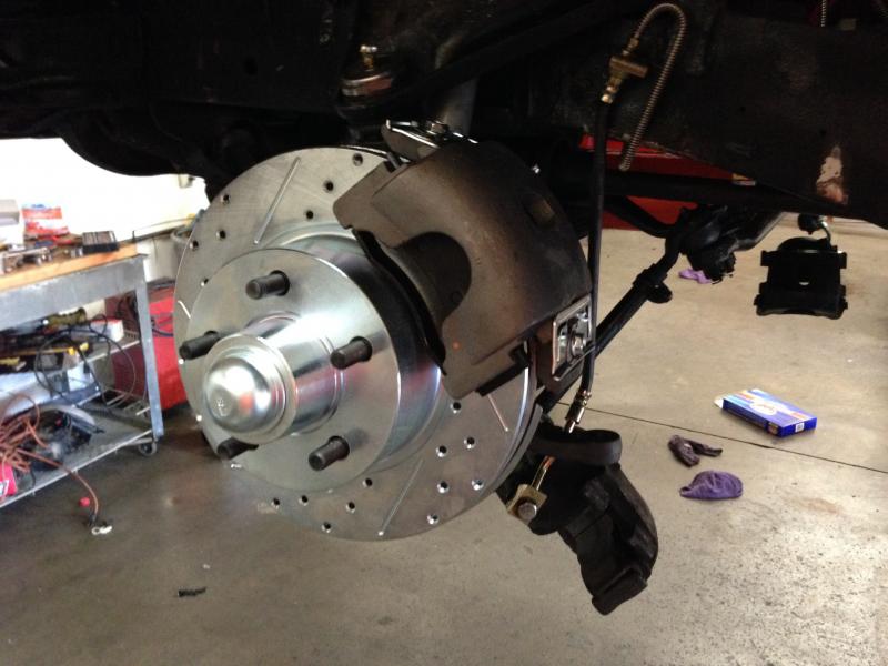

just upgraded to disc in the front but not sure which way the brake hoses should go from the calipers to the car as they were not part of the kit. any help or pictures would be great !thanks.
On my 72 Coronet the bakelines run in front of the shock Then hookup to the frame connection. It's easier to hook the line up to the caliper with the caliper off the car. Tthen feed the line where you need it to go. Its also easier to hookup the rubber line to the steel line then push it up through the bracket then push the clip on. I can take pics of my setup if you like
Does this help? I have rear hung calipers; they also could be front hung. These are a conversion as well.
