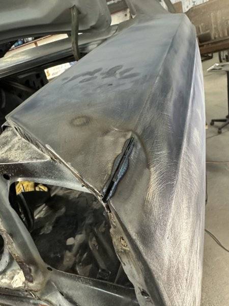

Here’s how I dealt with this issue today. The upper radius on the quarter was too tight and therefore didn’t match up to the quarter extension. As you can see in the pic’s I cut a relief line to bring the upper and lower in line with the extension then welded up the relief line. I then beveled the upper radius to match up with the extension. Prior to this I had to open up the mounting holes for the extension. I used a little heat to aid in forming the metal to the extension. I didn’t take an after pic but it turned out fairly well.
