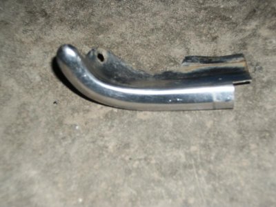

I am working on a 69 sport satellite and this is the first Mopar I have worked on. It didn't have the drip rail end pieces when I got it, I need to know if this is the correct end piece. I am posting a pic. Hope someone can help.
Thanks
Should interchange with a Charger and Coronet depending on if you have a vinyl or non-vinyl top. You might try yearone.com or jimsautoparts.com or a junkyard such as johnnydees.com..good luck
jaj36, thanks for the reply. In the description of that piece on E bay it says it is not correct for Plymouth models.Here is the description of it.I have a none vinyl top car and it does not say if it is for a vinyl top or not.
Please read and understand the full description and applications before bidding...You are bidding on a Hard-to-find, Correct, Original Mopar Dodge Chrysler Right Roof Side Drip Rail Molding Corner End, as pictured...Part number 2840884 for a B-body 1968, 1969, 1970 Coronet R/T, 440, 500, Super Bee, 2 door hard top or post coupe...Not correct for Charger or Plymouth models...You are bidding on one molding only for the passenger's side...It is in fair to good used condition for a 40 year old used part...It is not bent, but does have a small outward dent and some scratches...Could be polished for a driver, or straightened and buffed...See my other items for the left side, the door belt moldings, rear window moldings, front A pillar drip rail moldings, and many other B-body parts.

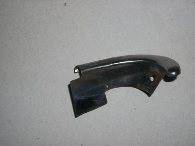

Just for future reference. This is the correct piece. The curve is flatter than on the other piece.
Thats the correct piece if you don't have the optional door belt moldings.
