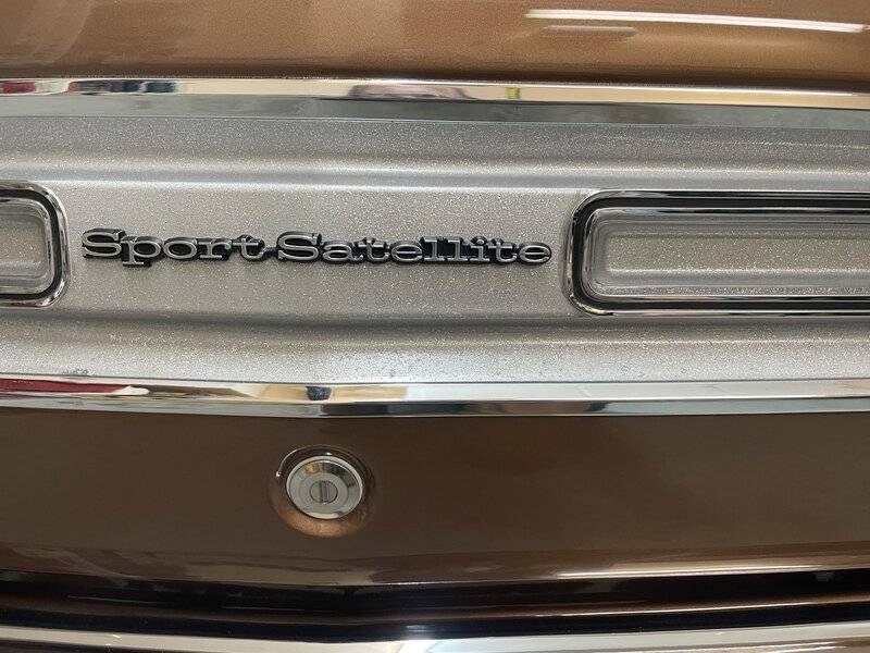

The Sport Satellite tail panel has the argent in the same areas as the GTX, The difference is the Sport Satellite has black insets instead of the red ones on the GTX. I just installed a NOS one on my car last week.
Sport Satelite is all argent with only a small black pinstripe in the very small inner bead so to speak
Here is the NOS one I just installed. Been stashed away for many years.
