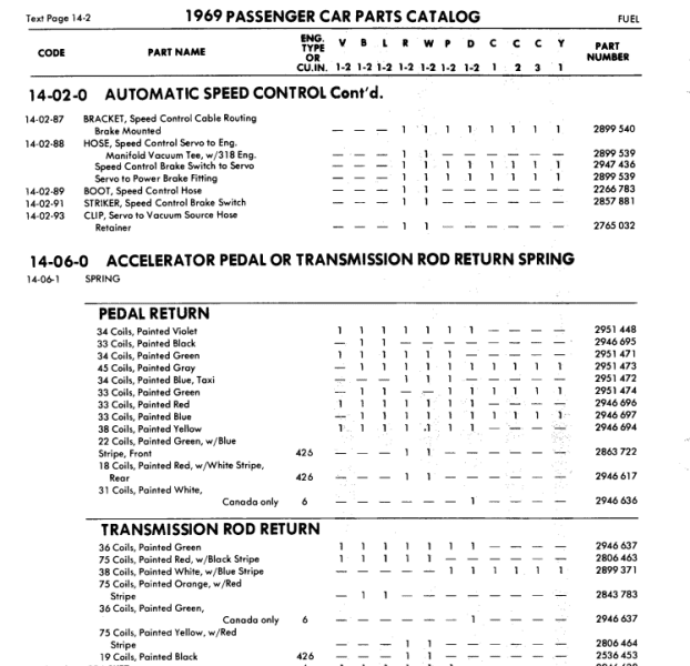

Looking to make my Throttle return Spring and Kickdown linkage spring correct for my 69 440 Charger.
From what's for sale out there I believe the throttle return to be grey...still not sure about the kickdown linkage.
Can anyone help me interpret the parts manual and the correct part number on this? Usually pretty good but this one confuses me!
I believe yellow is the correct one for a ‘69 440 charger.
Pretty sure its yellow and red #2860464 75 coils. Yes throttle return is grey & 45 coils #2951473.
