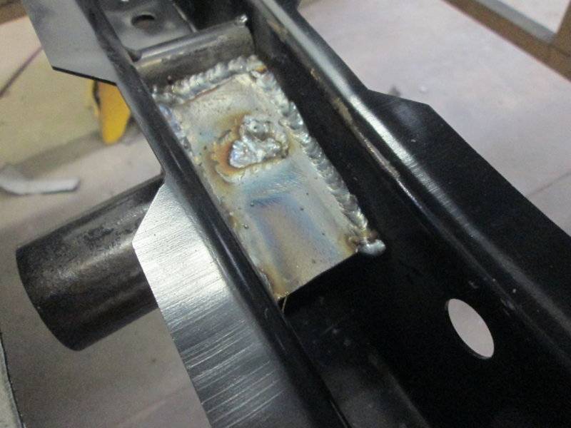

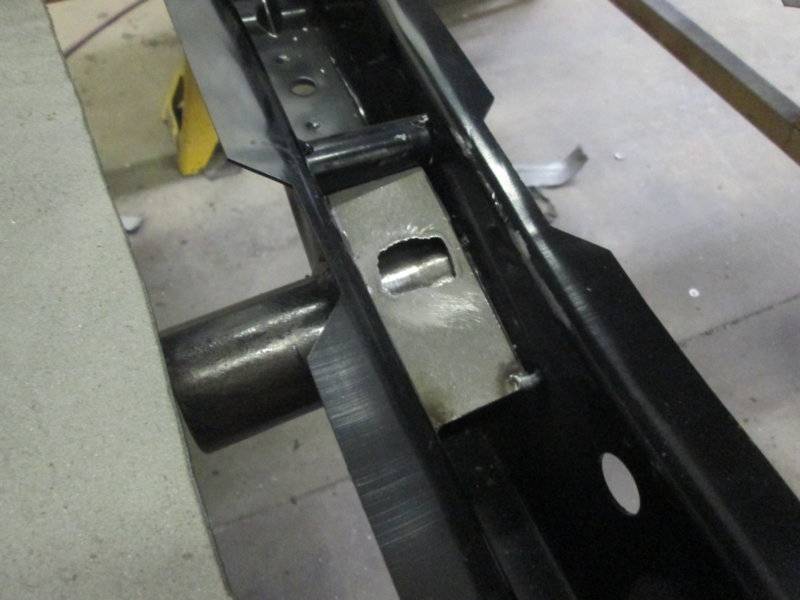

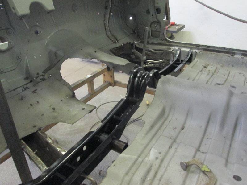

AMD fit nicely and no issues on assembly when putting in the torsion bars... reinforce the sockets while you're in there!

Your pictures look exactly like what I am doing now!! Thanks for the awesome re-enforcement tip, I will do that. Its hard to tell, did you use 26Ga steel for that small plate or something thicker? I will probably use something closer to 12 GA. I was afraid to dump that much heat on the socket, but based on your pic of the center weld, it appears to be a large enough heat sink to take it.
I am glad I am not the only one crazy enough to change that crossmember. LOL
RGAZ
It's either a 3/32" or 1/8" thick plate... been 2+ years!
Nothing crazy about changing out a rotted crossmember, it does hold the nose of your car up!
