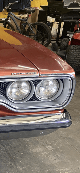

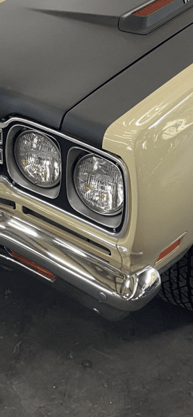

I just bought my first B body… noticed there are no remanufactured front fenders for the 70…
Apologize for my ignorance in advance…
Will a 69 roadrunner front fender fit a 70?
if not what are the differences if any and if so can it be made to work?
Most everything on a '70 is different, it's a one year only thing.
You can hang them but no.
Same here.
Thank you…
I can get every other piece I need except a fender… was just curious what the differences were or if anyone has been able to use even a portion of the 69 to repair the 70
What portion needs the repair? The 69 is the same at the rear edge where it meets the door, and the lower body lines are the same. The top where the 69 has the eyebrow ridge and the 70 is smooth is obviously different, and the front few inches for the headlight area won't match up. So if it's just the bottom part that you need, you can use a 69 for patch material.
