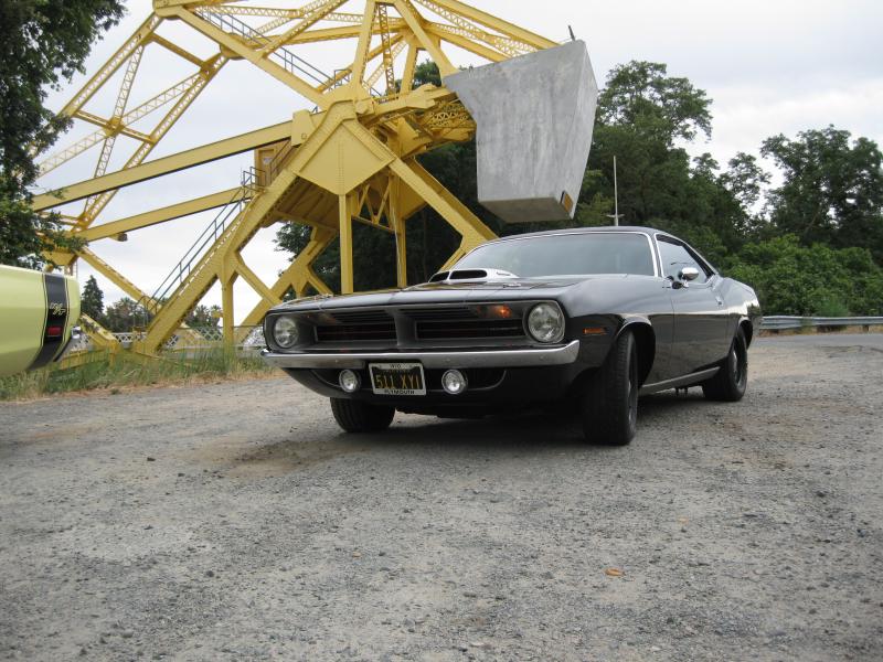

SacRanchoCordoovaJune22,2013 017.jpgA friend with a 6 pak 'Cuda is always messing with the tune. That said, when it does kick in it scares the crap out of me. I check that my seatbelt is clicked in, and put my hands out on the dash. The waaaahhh of my 850 Demon 4 barrel can't compare. Scare factor. Nothing like it. That's good.
