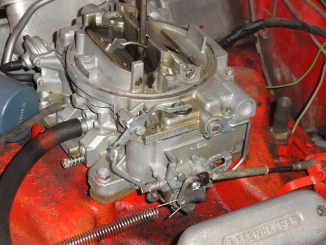

This is the other side of the carb.

Sticks as in it won't release after the engine starts to warm up - or the choke plate won't set on a cold engine? If it has a divorced choke wtih a bi-metal spring in a well on the intake, possible the spring or rod is binding on the well cover or the vacuum choke pull off is not holding vacuum.
Choke works fine, It just doesn't quite go far enough to disengage when it's warm. I will try bending the rod a little to get it to open all the way. Thanks for the help. Sorry for the double post, I messed up!
