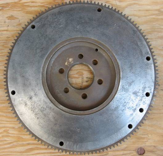

A 1970 440 HP engine with six pack rods and crank would use a 1970-72 440 six pack 10-1/2 inch flywheel 130 tooth
I posted that flywheel for sale under mechanical parts on page 2 the other day.
Since you need a 11" for a 69 & not the 10.5" for a 70 which uses the 10.95 scalloped clutch I would purchase a 69 11" flywheel which is neutral balance & take it to a old school machine shop that does balance work... I know off three local shops who all have the info on the balance specs for a 908 rod 440.... Shouldn't be a big deal..

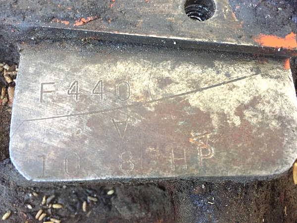

Just an update:
After visiting 440 Source’s website and getting educated on dampers, I can confirm that my ‘70 440 HP has the “six pack” rods as R/T Boy 67 posted.
The only bad thing about going to 440 Source website, is now I’m drooling to build a stroker.
