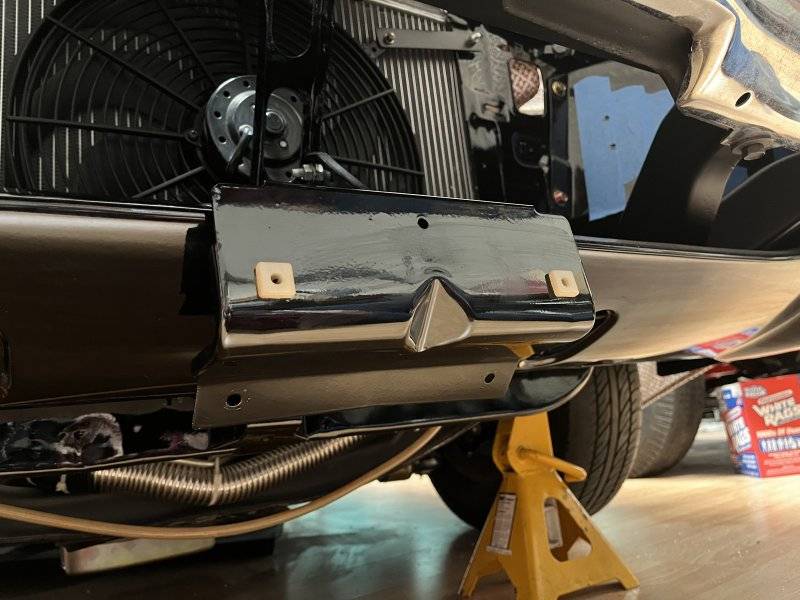

Hi ! I've been hunting a front plate bracket for my 70 Charger and been sold 2 useless pieces of steel so far. Would you mind showing us your bracket and how in mounts on the car, please. That would help me a lot. Thank you

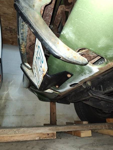

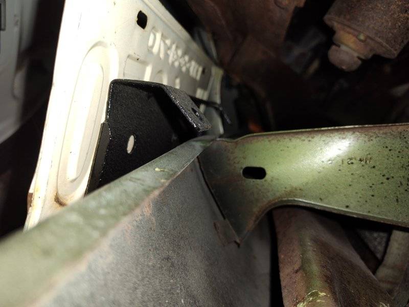

Bolts on with existing holes in the valance
There's probably a bracket to hold the upper edge but mine is fine without anything besides the 2 lower bolts.

Okayyyyyy. ! Thank you so much. Guess what ? My brand new AMD valance did not come with the 2 holes and this is why it was not obvious to me as to where the bracket went. My bracket has a lip that clips on top the upper lip on the valance. Thank you so much for your help and taking the time to send these photos. Much appreciated. Happy Holidays to you.
