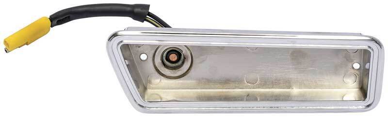

While restoring my sidemarkers, I found that only a few had the pigtails still attached; most of the housing assemblies just had open holes. I seem to remember when I removed them from the fenders/quarters years ago, the pigtails & bulbs just popped in from the inside, but when I looked at the few I had with the pigtails still attached, they were crimped in and impossible to remove the bulbs without damaging the crimping on the inside. How are the pigtails & bulbs installed? Thanks.
EDIT: It seems logical that the pigtails/bulbs would just press in from the inside, so changing out burnt-out bulbs wouldn't require complete disassembly of the sidemarkers. Just that the few housings I have with pigtails crimped in permanently threw me off...so is it correct that they should just press in from inside?
pigtails are crimped in housing,bulbs are changed when housing is removed from car
Thanks, I was hoping that wasn't the case. That's a bad design for maintenance, having to remove the sidemarker retainer and housing from the fender, then unscrew those fragile plastic lenses from the housings, just to change a bulb...every time you screw in one of those lenses, you risk cracking the mounting posts. Fail!

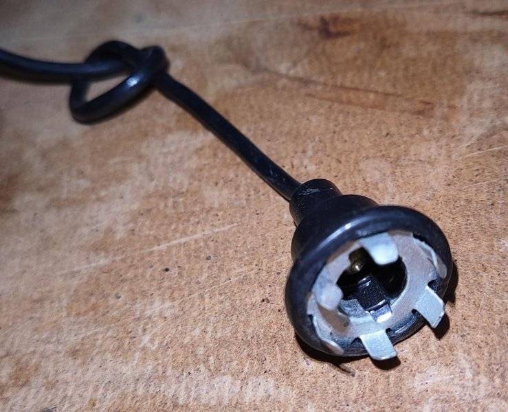

Update: Okay, I found a bunch of these pigtails in my parts baggies, and they perfectly fit the sidemarker housings, simply popping in from the inside. I notice that they're a single wire, though. Maybe they ground the housings to the fender? I need a closer look at my existing wiring. Will update shortly.
