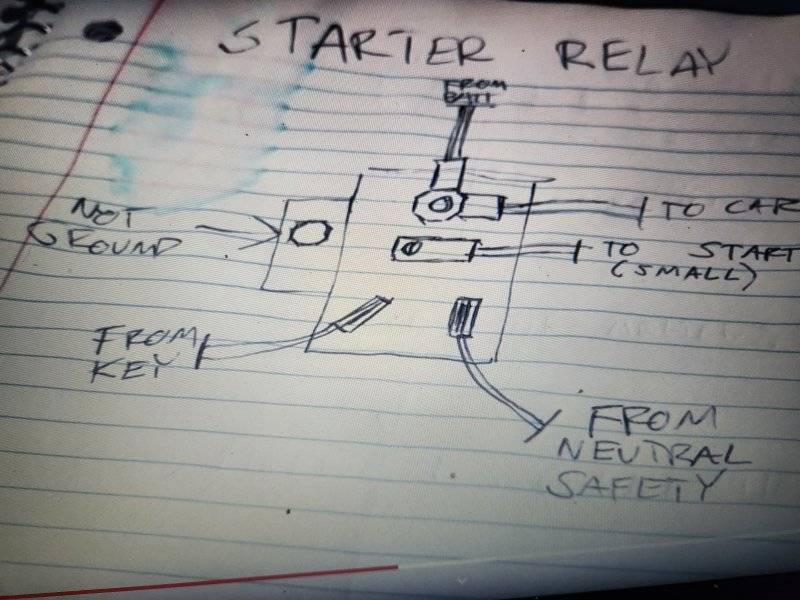

ok 70 charger 318 It was starting but no go. Starter relay has power on main post ,neutral brown wire has ground,
no power on Key line-yellow wire. I tried jumping posts on relay to check starter 1 click so pulled starter and tested it and it engaged 3 times. I have power to amp meter both sides.I have 4 ways.Power on ignition plug on steering column. I have extra 70 steering column so I laid it the charger grounded it and plugged both connectors and would not start,4 ways worked on that column so has power. I thought if you jump post on starter relay it will turn starter over. Could starter be bad even if it engages out of car? Also what else do I check for power on yellow wire. Both Ignition keys cant be bad.
