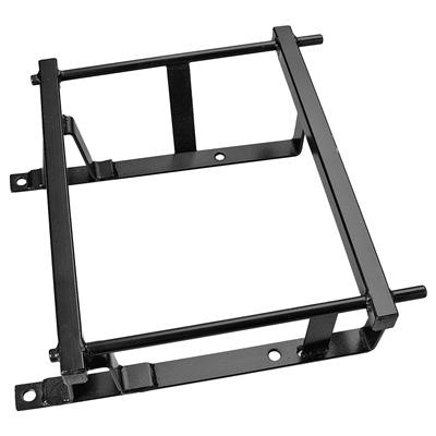

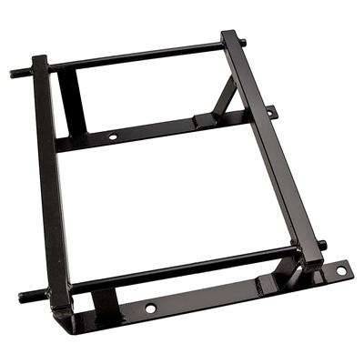

I have the Elite 1100 ProCar/Scat seats & seat brackets
the brackets have an adjustment to them

Pro Car Seat Adapdter Brackets Driver side SCA-81342 $77.95 Dodge Plymouth.jpg
Pro Car Seat Adapdter Brackets Passenger side SCA-81343 $77.95 Dodge Plymouth.jpg

you will need to drill the inner {near the tunnel} holes on both sides,
the OE bench seat cars don't have them pre-drilled
easy deal, all bolt in perfect fit too...
The adjustment is in the front {& rear ?} IIRC
of the bracket that attach the sliders to the lower seat brackets

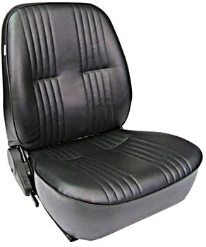

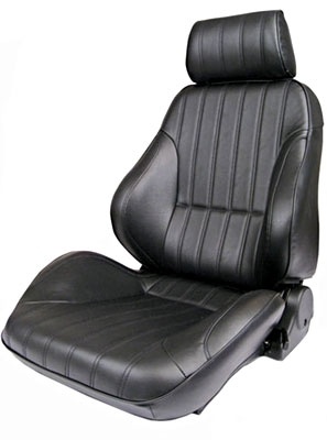

they have other style seats too, here's a couple
