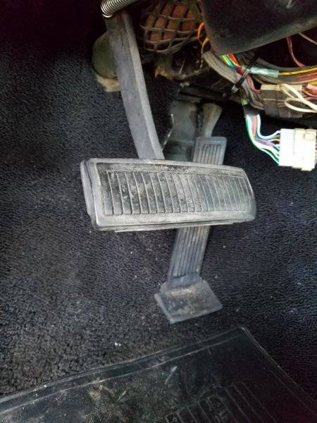

I'm at a loss on this. The brake pedal sits WAY to high. I thought that moving the spring would help. It did not. Any ideas?
Did you change out the master cylinder / vacuum booster?
I just bought the car. the pedals were like this.
Do you know if the brakes were converted from manual to power?
they are manual brakes. I took the spring off. It helped a little. I'm wondering if the wrong pedal or wrong rod to the cylinder was used
It could be a couple of things. The master cylinder piston recess could be shorter, causing the increase in pedal height. The pedal push rod then makes the pedal stick out further. Take a look and see if there is an adjustment for the push rod (threaded). If the brakes are working well, then just adjust the rod to get the pedal where you like it. If the rod is not threaded, then look at Classic Industries for an adjustable rod. If your brakes are not working the way you like, then most likely the cause of the high pedal is related.

thanks!! I greatly appreciate your comments!!
