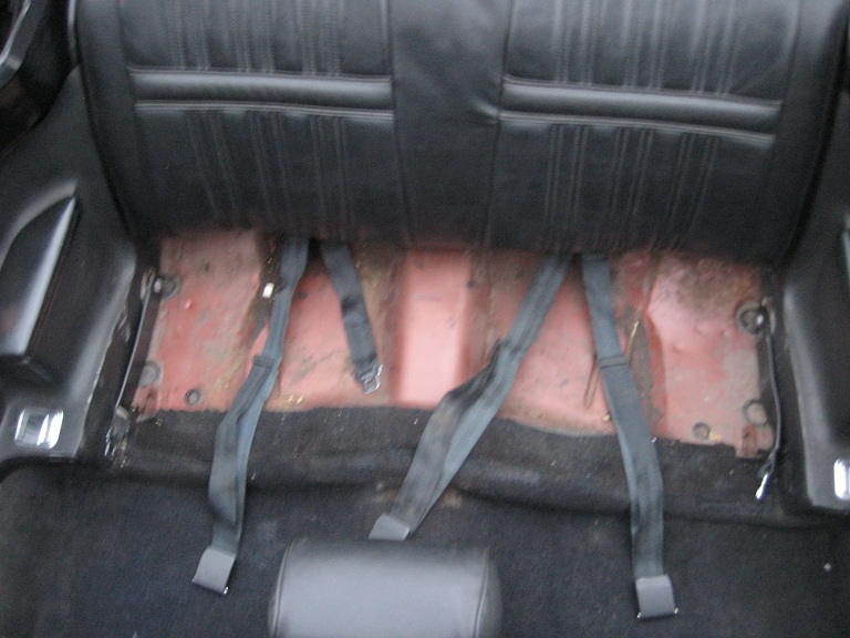

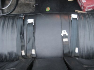

Long ago the interior came out of my 70 Coronet Convertible, Bench seat, Auto on the column. not sure what seat belt goes in what location. Any help is greatly appreciated. diagrams, pics ect. on proper location..............
Split bench like mine? I can take all measurements and give to you.
Sven
Sven, split bench JUST like that ! that would be great, along with the measurements, there are 6 bolts, 2 long and 4 short, can you see what bolts hold the front belts to the floor ? Im guessing it's the 4 short bolts that go to the front seat and the 2 longer bolts go to the rear seat belts. Could you take pics of the belt retractor on the out side front seat ?
Thanks for the help
Sorry for the delay wife keeps me busy, there are numbers on belts, front driver has 4760 center 4752 4760 pass 4752 rear 4780 and 4781, long bolts back, if you need more pics or measurement just let me know.

Ya I know how it is, that is why it's taken 20 years on my car, thank you, I will keep you posted
ok, the problem that I have is, I restored the seatbelts and dyed the part numbers in the process. based on the pics I have a home for all the seat belts, just not sure on the front 3 with the buckles. there are 2 different lengths, does the longer one go to the driver,center or passenger
thanks for the help, the seat belts now have a home
