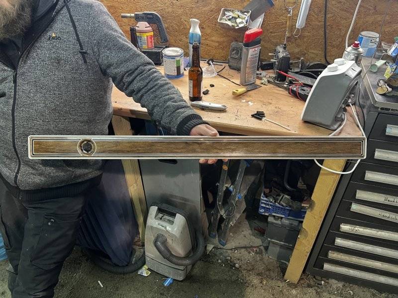

Hey, i wanna mount the Trim to the Door of my 70 RT but i can‘t find Clips or fasteners for the Trim….
Any Ideas ? Greetz
The original clips are super hard to find. I have seen guys take a piece of flat and tack a very small screw to it. The key is a very shallow head on the screw. Then use an acorn or similar nut from the back side.
