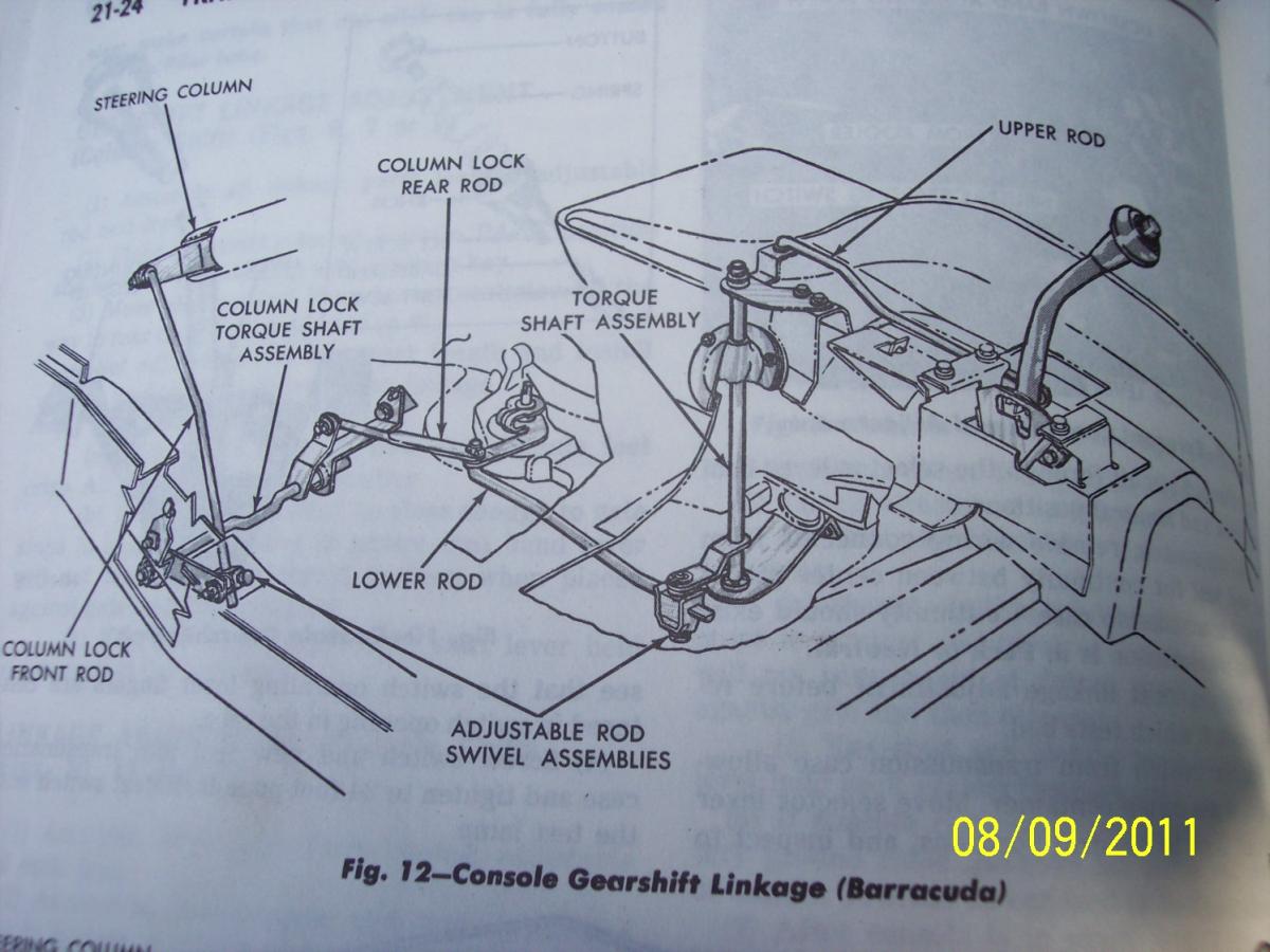

Is there supposed to be a linkage to connect the steering column to the transmission so when it is in park , it locks?
I assume you're referring to an auto on the floor shift car? The answer is yes there is some sort of lock out rod.
I wish I could figure out what it looks like and how it hooks up to the transmission
70 lock linkage
i wish i could figure out what it looks like and how it hooks up to the transmission
Frank
Hope this will help.
