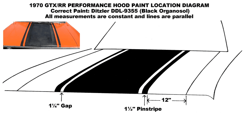

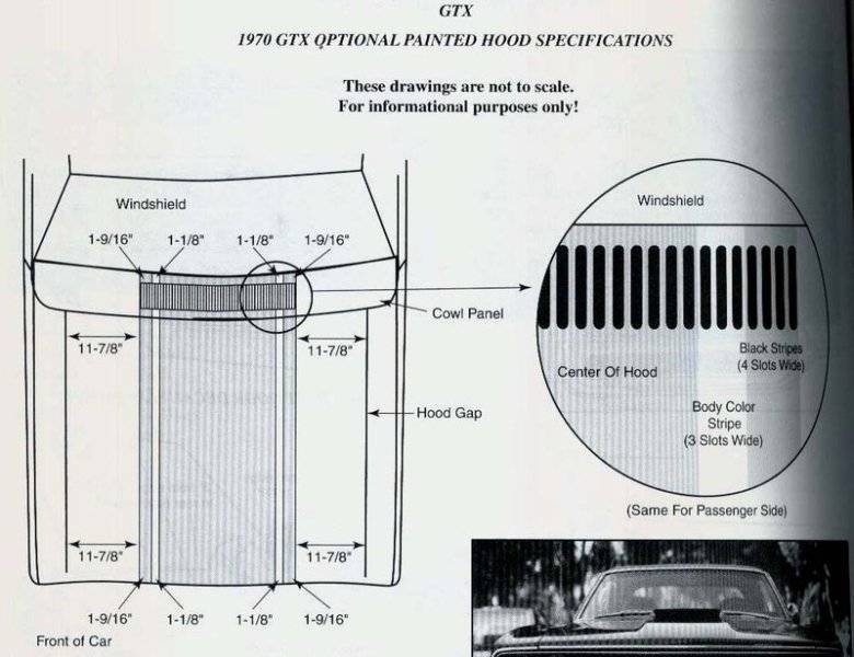

Does someone have a picture or definitive dimensions of the hood stripes on a 1970 Road Runner? I can't find my "before" pictures and I'm seeing two different sets of dimension online. THANKS FOR THE HELP!

I used the dimensions as per the YearOne catalog back in 91 but I’m sure some survivor guys will chime in on V21 specs

That is what I used.

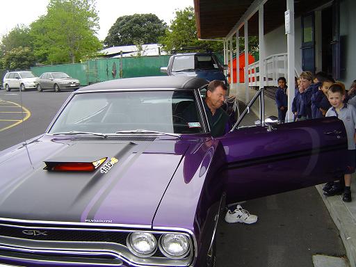

Anything but that diagram will look a bit funky......it doesn't take too much deviation to just look wrong.
^^^ BTW, that last photo - my face is the result of floating an air biscuit moments before getting out of the car :lol:
I`ve seen both of those drawings, would be nice to have measurements off a survivor to verify which one is closer to factory.
