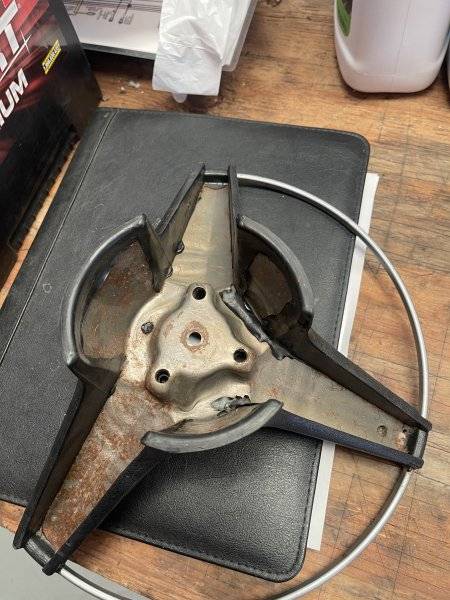

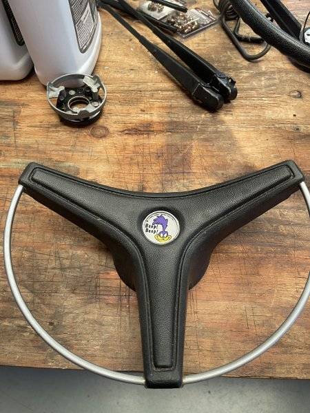

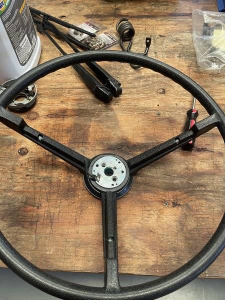

I got a steering wheel from PG classics and a horn pad off eBay. I have the switch from a different wheel. How does this horn pad mount? I must be missing something.

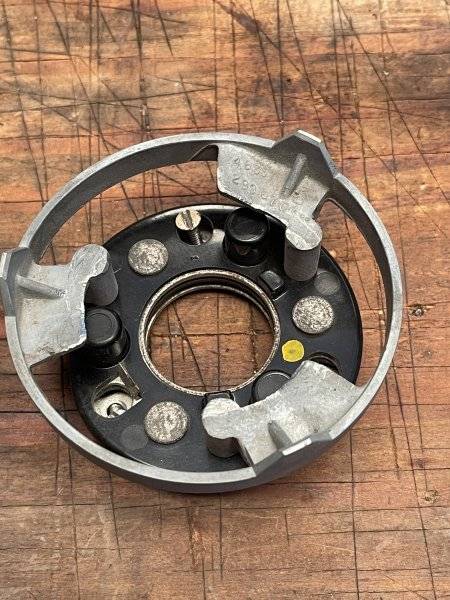

I think your switch is for a wood grain type steering wheel and will not work with a standard wheel.
Looks like it doesn’t it. Was thinking that. You’ll have to remove the center medallion and then bolt it down. Car so you don’t break it

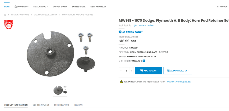

You have the wrong switch assembly for the 70 deluxe steering wheel. You will need the correct one + the horn retainer set shown above.
What does the correct switch assembly look like and where can I get one? Thanks
Can’t I just add the Classic Industries part above to the switch I have and achieve the same thing?
No...you need the correct switch assembly for the deluxe wheel. The one you have is for the standard 3 spoke wheel. I will check...I may have a complete setup.
