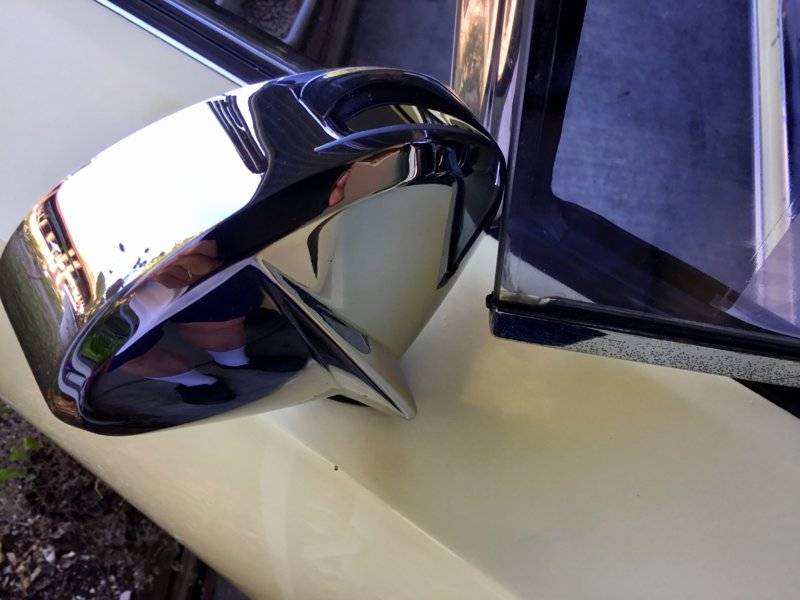

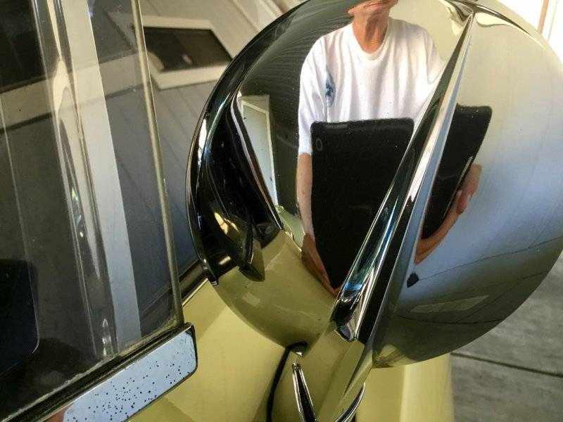

And make sure you position it correctly so the vent window opens.

I've been down this road on my 70 RR (twice). I could never find the "exact" location to mount it. 1st try, I just lined up the mirror compared to the driver's side mirror (adjustable), drilled the two holes & installed it. It looked good, but I couldn't adjust it well enough to be useful for safety checking my blind spot. 2nd try (did this last week), I moved the mirror back about 1" & now it works perfectly.
Also, these guys are right that if you're not careful, you can mount it in a location that will catch the bottom corner of the vent-wing window when you open it. I don't have this problem on my passenger mirror, but for some reason my driver's adjustable mirror just barely gets clipped by my vent window when I open it. I'm planning to move that mirror back 1/4", fyi. I do have the advantage that my car isn't painted yet....take your time....measure twice and drill once. The making tape idea sounds like a really good one.

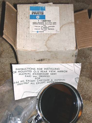

If it's NOS (which don't pit, well at least mine didn't), it should come with instructions including location/drill template.
