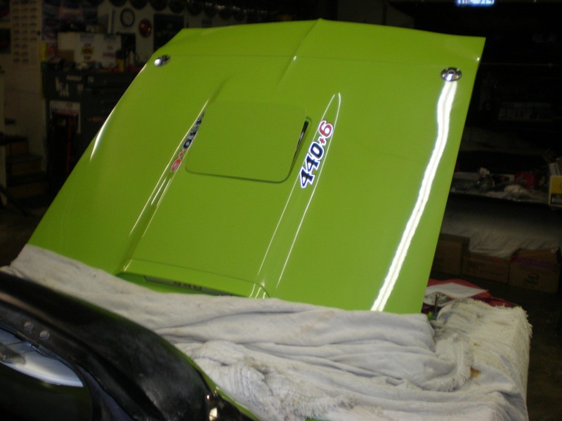

One more ? The hood has the hole for the air grabber scoop but nothing else.Is there a way to tell if it a original or just one with a hole cut in it.I would maybe consider buying the scoop if i know it will fit the opening.If i am reading the fender tag right i think it would have came with just the bulge hood.

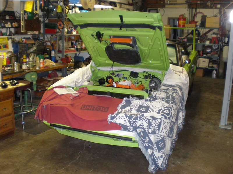

I'm pretty sure there is a "step down" all the way around the hole so the "scoop" will sit flush with the rest of the hood when closed. There should also be a series of holes on the bottom of the hood for all the things that make the scoop go up and down
The top of hood pic pretty much answered my ?I have a bulge hood with a hole cut in it.Ok do i leave it and make up a functional grabber type scoop to fit the opening or weld it shut?Or look for another hood?.It had a fabbed type grabber scoop mounted but permanently open.I know i can make something that will look close.What should a guy do?Anybody?And thanks for the pic it was exactly what i was looking for.
Eastwood sells all kinds of bodyworking tools, including flanging tools. IF the hole is just the size of the factory hole, then you might consider flanging the hole so you could use the factory stuff. I'm sure moparstuart would be glad to measure the hole for ya.
they already make a weld in kit preformed for a air grabber opening also . buy that and it makes it easy .
