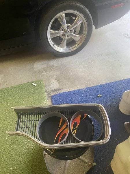

The drivers side, low beam headlight on my 70 Road Runner needs to be replaced. How do you access it to remove it? I'm not even able to see the plug connector let alone get to it. Any tips are greatly appreciated.
Remove the ring. 3 screws. You may need to remove the bezel as well.The drivers side, low beam headlight on my 70 Road Runner needs to be replaced. How do you access it to remove it? I'm not even able to see the plug connector let alone get to it. Any tips are greatly appreciated.
After loosening the three screws that hold the headlamp in place, rotate it slightly and pull it off. The screws go through a keyway so you don't have to remove them entirely. When the trim is off, the light can be pulled out (will likely fall out) and you can then pull off the connector.The drivers side, low beam headlight on my 70 Road Runner needs to be replaced. How do you access it to remove it? I'm not even able to see the plug connector let alone get to it. Any tips are greatly appreciated.

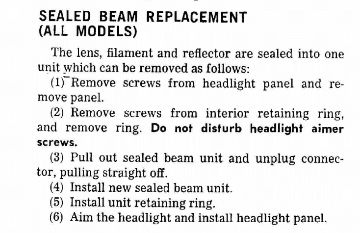

OK thanks. I was hoping I didn't have to remove that. 53 yr old, brittle plasticRemove this. View attachment 1463444
Thanks!! I'll just need to look for a headlight.This is out of the 1970 FSM.
