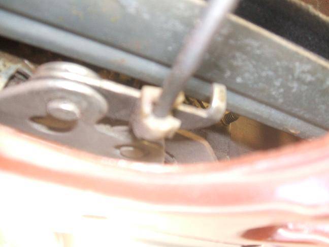

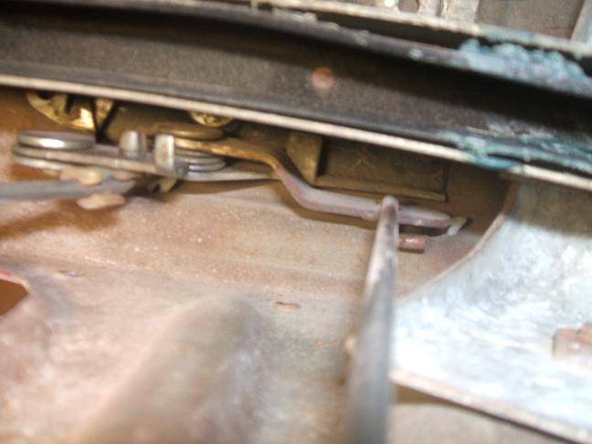

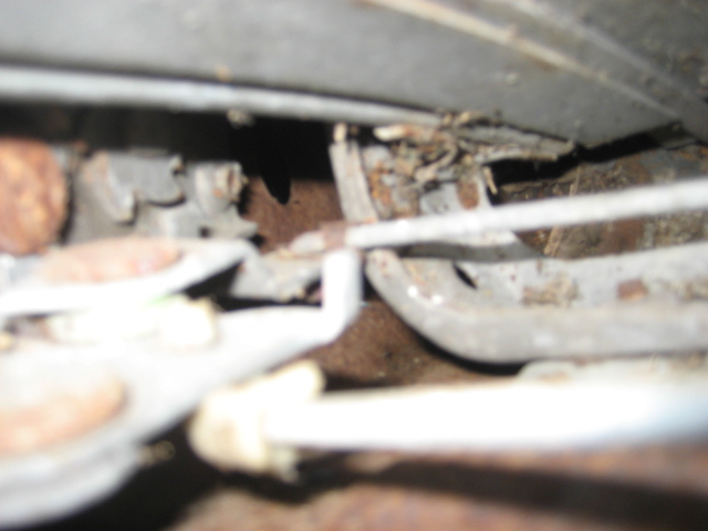

Have a 70 RR. One of the rod for the door latch is loose and rattles around. Have included a photo. Is their supposed to be some sort of clip on it to keep it from rattling around? The rod for the lock has white plastic clip on it and it is tight and quiet....
The one making all the racket (no locking clip)
The other one with the clip on it
That certainly could be the source of the noise. Did you look at the other door for comparison?

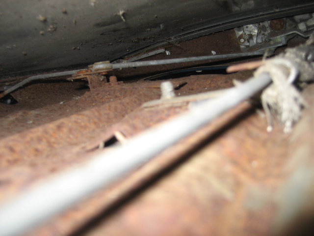

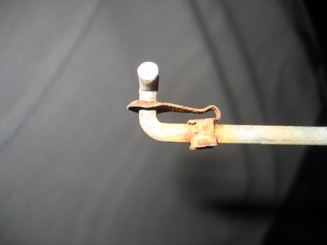

Hi : On the long lock rod ,there should be a braided like sock over it ,at least a foot long. This rod also lays in a "J" clip that is screwed to the door frame & there is also a clip on the latch end that keeps the end of the rod from vibirating in the hole of the latch. If you`re not sure about these parts & you would like, i`ll see about sending a few pics. My 2 cents
Please do send or post photos
thanks
NO !! Rattle Rattle

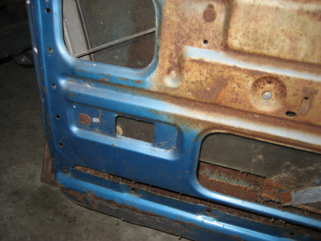

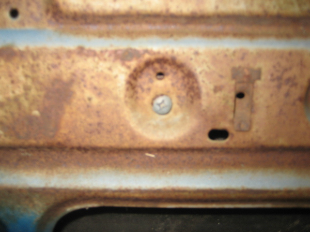

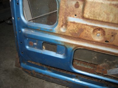

Here`s a few pics. The "J" bracket is screwed to the door with a philips machine screw & the rod lays in it`s sock, in this bracket, This particular rod has a VERY worn braided cloth-like sock & the last item an anti rattle clip on the lock rod mechanism end. Hope these pics help.
