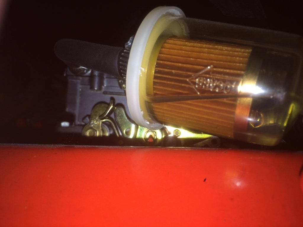

Exactly as Dennis mentioned, if you are running a blended Ethanol fuel you're going to have a bit of an issue starting it once it's hot. I went through the same thing with my Bee and one of the first things I did was switch out the fuel filter to a Fram G2. At least running this filter you'll have visual confirmation of fuel at the carb.

Fuel level looks fine...although it may have percolated out of the bowls. Has it always been hard to start once hot? Are you running any kind of carb spacer?

I am used to seeing my fuel filter full when running, unless yours has drained out after some time? Is your fuel pump up to scratch?

Located above the valve cover, it is also picking up heat from the header. On a 383/440 the fuel filter is typically located in front of the block. It might help to relocate to just below the alternator.
Thanks for the help, I ordered a phenolic spacer. Tonight I will try and relocate the fuel filter and move it down around the alternator.
Before re locating it, the fuel level in my filter looked like that. I now have the filter outlet pointed upward, and it always stays full of fuel. If it doesn't. then there is something wrong somewhere.
I'm going to relocate it so it is upright and then test the fuel pressure on friday.
