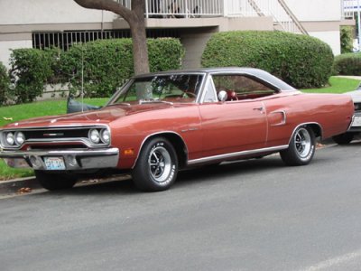

this car used to belong to my father, he purchased it new in 70. I had the opportunity to buy it twice but at the time it wasn't possible. Found the gentleman with the car, and had a chance to look at it and take a few pictures. sorry not the best pictures as the batteries in the camera went dead and had to use my phone.
how do you tell which 383 motor is in the car. i think they came in 3 different hp options?

Now the way you tell what engine CAME with the car is by the VIN and fender tag. The 5th digit is the engine code. The codes for 383s in 1970 are:
L = 383 2bbl
N = 383 4bbl HP
Your fender tag VIN has N, so that is the HP engine. You fender tag also has E63, which is the 383, 330 horsepower engine. These were painted blue, while the 335 horsepower engines were painted orange.
By the looks of it in your pictures, there is a good chance this still has the original 330 horsepower engine.
Nice car!
the guy who owns the car is the third owner and as far as we know that it is the original motor, never been rebuilt.
sweet... question about the side vents... those are gtx or rr side vents arent they? the SS had chrome trim didnt it?
Nice car!! You should do everything you can to get it back.
when i was speaking with the owner, he said it would be nice to have it get back to the original owners family. he still has the original bill of sale with my dads name. Doesn't sound like he is ready to sell but said i'm first on his list, if/when he does.
not sure on the side vents, or chrome trim, were these able to be ordered from the factory?
I thought they were standard on the Sport Satellite? Just like the chrome tirm for the vinyl roof or something
