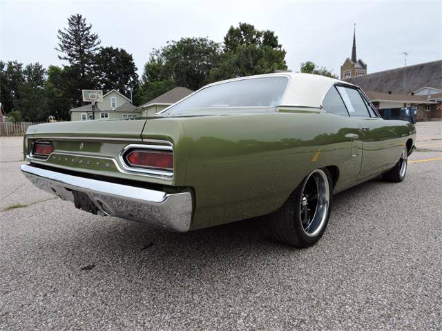

I need to narrow down these mouldings
can someone who has these please post pics of the trunk moulding and how it connects to the leafy and right ones ? Onto the center ? I see about 6 mouldings on some cars so I’d like to know what I’m looking for.
I located the side ones for a good deal so I’ll have those soon
Are the trunks different? Because I can’t see how they attach on the green car against the blue one
Do they go on the edge ? How do they attach ?
These are a car on the internet I saw but also saw this one
The green car is a satellite and it has all 4 of the correct trim for a satellite. The trunk trim slides over the Bottom edge of the lid and has screws to retain it.
A GTX and sport satellite add 3 more pieces To what a satellite has. The trunk trim goes on the rear face of the lid. It has a hole on each end with a stud and nut, the center is held on with double back tape. The side trim pieces have 3 long studs that go inside the trunk with nuts on them. And a screw through a tab that you access with the lid open. So there are holes in the quarter extension and the body.
The blue car is missing the trim the green one has on the bottom edge of the trunk and it should be there.
