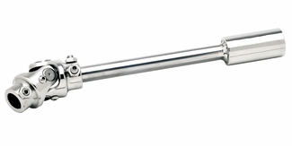

Power steering column shafts are shorter than a manual steering column shafts buy several inches {I think 3"-4"s} on 68-70 B-Bodies anyway... They require an adapter, like below go from Power to manual, so there is a significant difference in length, as for the swapping shafts, from one to another housing on different years, I don't have a clue...
