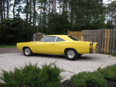

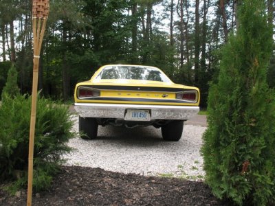

Here's my stance.
Stock spings. One extra on the right rear. The car squats real well upon hard acceleration. LOL
