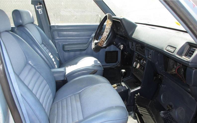

These are in an omni
odge%20Omni%20Miser%20in%20Colorado%20Wrecking%20Yard%20-%20photo%20by%20Murilee%20Martin%202017.jpg
FWD Daytona seats were OEM Recaro (or at least licensed) IIRC.
I like those. Only issue is finding the older buckets without rips, mold, smells, etc is difficult. Plus most are cloth. If I will need to recover I might as well buy new aftermarket from Sum or Jeg, etc. Also...not a deal breaker but would like something post 2011 so possible to find ventilated/cooled seats. May have to remove the headrest so flat seat top needed. Most are notched.
