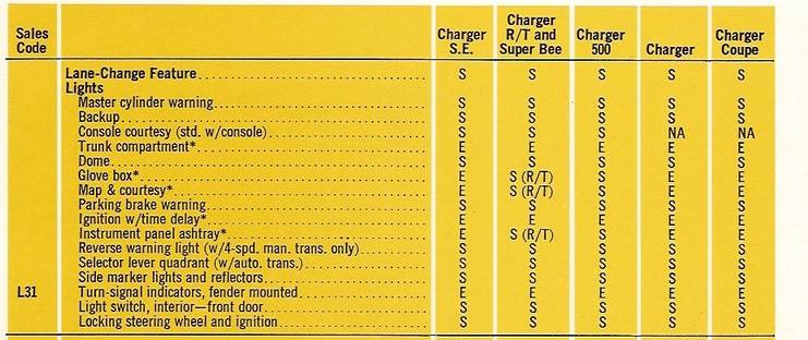

Makes perfect sense they would be included but according to the 71 data book they cost extra. Maybe added later in the year?
*= A01 Package

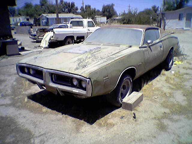

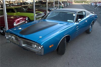

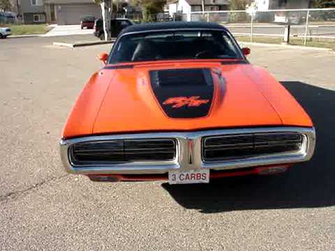

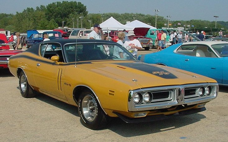

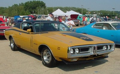

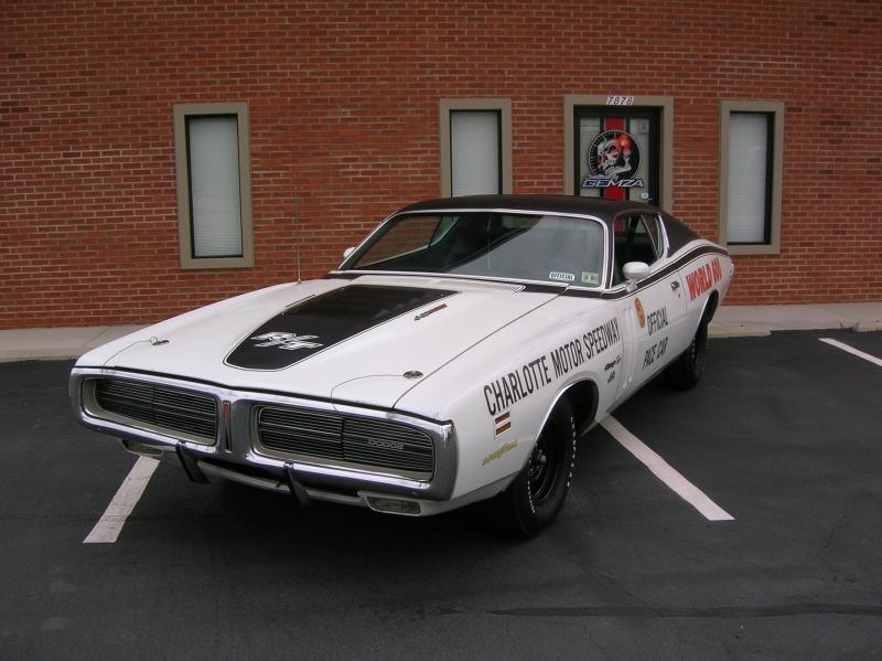

I have a problem with all the cars up above there all top dog fully decked out cars , I wwould buy the striped out cars not getting them (possibly) but fully loaded cars ? Now if someone could find a picture of a survivor that is documented as being as such with its org paint I'll be quite . But to me all the cars above more then likely had the light shaved off . (Very easy modification ) and very common .
I know the man to ask I'll give him a shout Monday so we can figure this out .
unrestored , original paint cars
All the cars shown above are 71-2's. Both my 71 R/T and 72 Ralley that were sold new here and in original paint when I owned then did not come with the lights.
I've also owned a several of GTX's and SSP's with out the lights.
I've owned over 60 71-4 B-bodies and most of mine did not come with the lights. Both the 71 and 72 SSP's that I have now have them but both have the AO1 light group. They were more common on 73-4 than 71-2.
