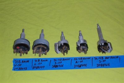

71 wiper switches are 1 year only. 72-4 are the same. 71 was variable and 72-4 was 3-spd or 71-4 could have a 2-spd.
