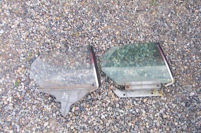

1st pic shows 71 roll down and 71-4 fixed

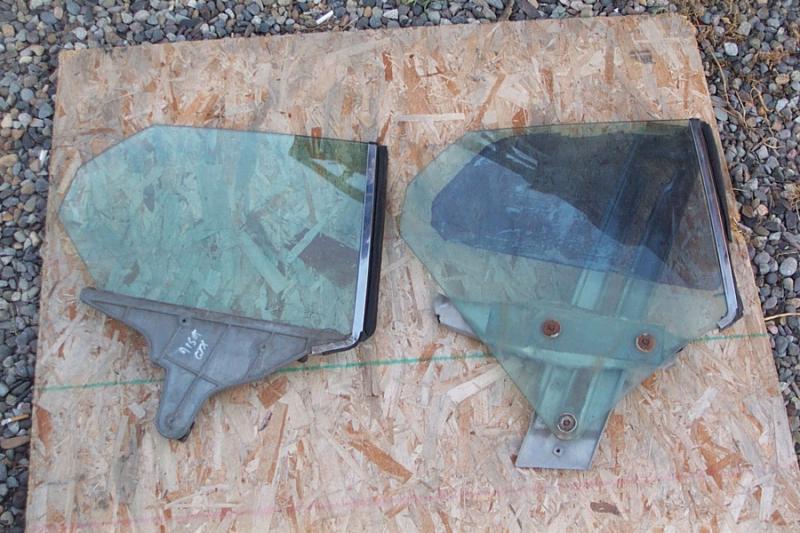

2nd pic shows 71 verses 72-4.
Both pics are Satellte glass. Thought a had pics of Charger glass but I guess not. Will get some.

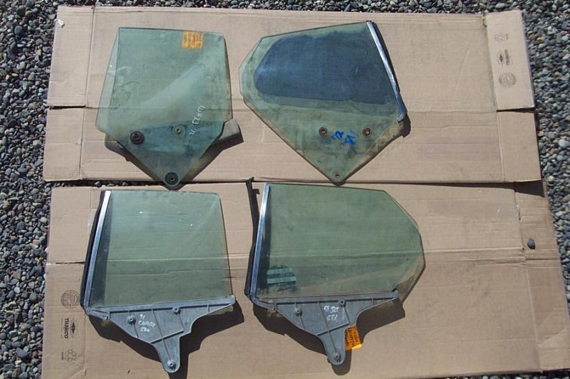

Here are the 71-2 quarter glass
Top is 72 bottom is 71
Left is Charger and right is Plymouth
Still working on 73-4 rescearch but think they are the same as the 72 setups
