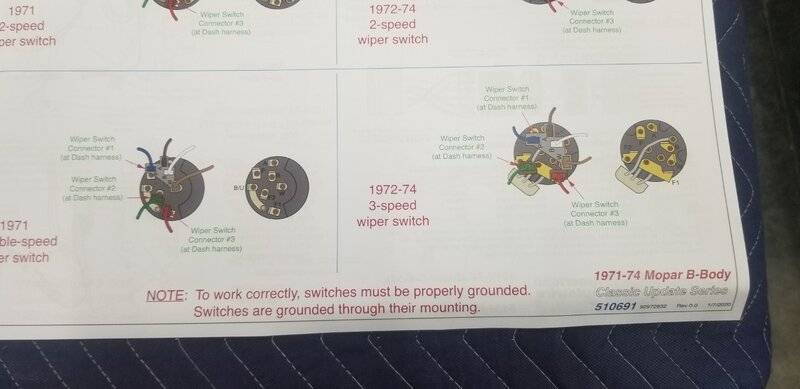

Just a note be sure you get a 71 switch as the 72-4 switch won't fit in your 71 cluster frame without cutting a notch in the hole.
I'm using an aftermarket dash insert (Classic Dash) and aftermarket wiring harness (American Autowire).
Does a 72-74 still work with the 71 variable motor?
The connectors aren't an issue as the wiring diagrams show both the 71 and 72-4 utilizing the same connectors
