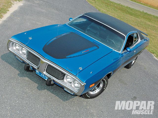

This hood is from a 73 Charger (power bulge) and I plan to install on a 71 Charger project in the future. I am gathering parts needed and was trying to decide on using the 73 or not. I know the 71 hoods had the vents all the way across behind the bulge. This has 2 sets of vents (1 set on each side) behind the bulge.

I don't have a pic of it on my computer. I will get one at Christmas when I am up there at the shop. The hood that I have is just like the one in the pic below.....two sets of vents behind the power bulge area. Are the bulge dimensions the same on all 71-74 raised hoods? Just different black out designs??

The dimensions are all the same, only changes were in the air vents. The black outs were a year to year change.
