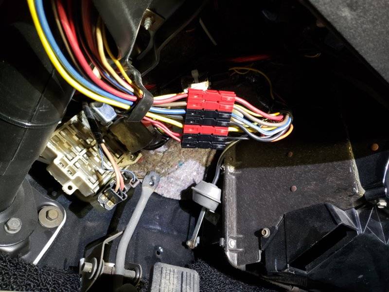

More than the gauge wire on these, is better to take care of the best terminals/conectors, which on this plug could be the weakest point. 72roadrunnerGTX posted quite ago a great terminal/plug set up for these used on his car, which I had found it quite ago but didn't know they were stackable untill he shown his car setup, which make the assembly work and look like a stock setup and keeping the order there. If I found the pic &/or the terminals will post. Maybe he will read and post by himself before I post.

Anderson PowerPoles
where did you get that connector and the terminals that go with it? is it aftermarket?
