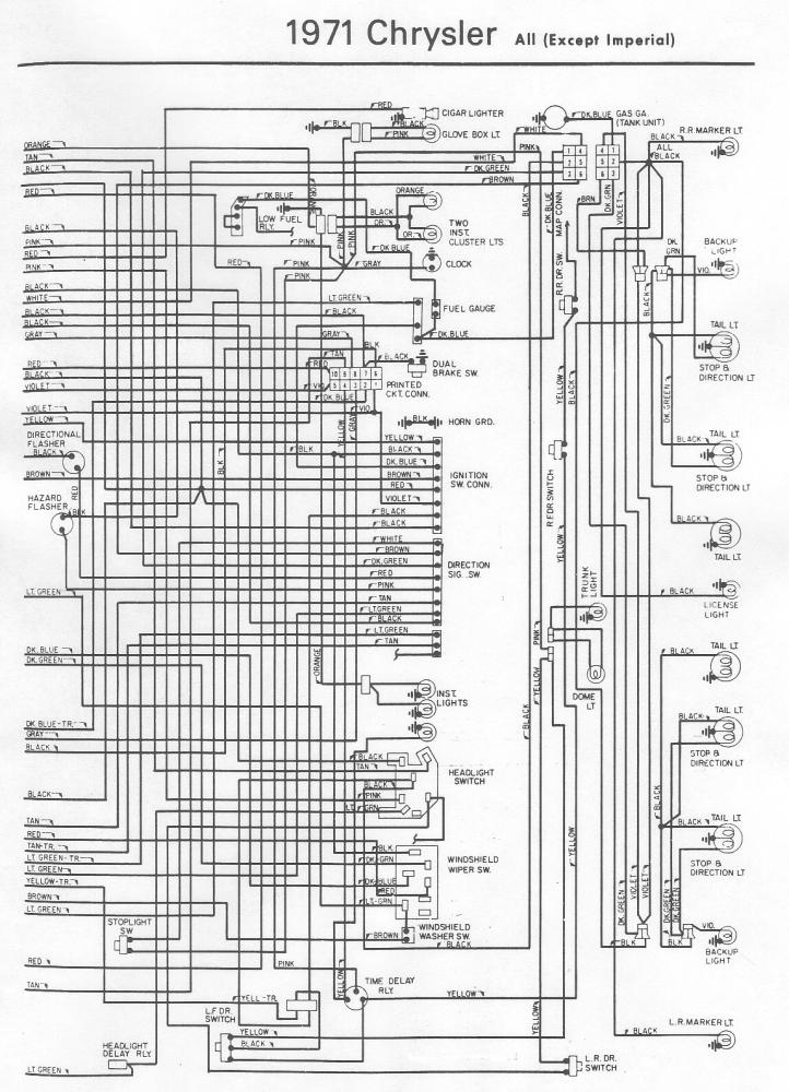

Does anyone have a tail light wiring diagram for 71 charger (base model).... the one I have from mymopar.com shows an 8 position connector. The actual harness plug for the taillights is a 4 position connector.
thanks for any help

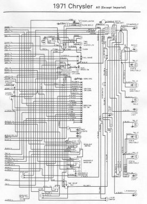

Here is the one I have, but it shows a 6 connector plug. Sorry. In any case, figuring it out shouldn't be too hard. For that connection you have left and right turn signals power, brake/tail light power, the side marker light power that runs off the tail light power, and the liscense plate that runs off the tail light power, and the fuel tank sender. All the grounds go to body and not the tail light connector plug.
