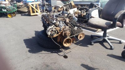

So I've acquired a '77 440 from an old Dodge RV and I currently have it sitting in my garage waiting to be rebuilt. My wife and I just moved in to a new house and our budget is pretty strict at the moment, but when things get less tight is probably when I'll go and have it inspected and get any machining work done. She looks pretty solid and when I drove her in the RV she seemed to run pretty good. I'll probably log my progress ITT just for anyone who's intereted. Here's some pics for you visual types:

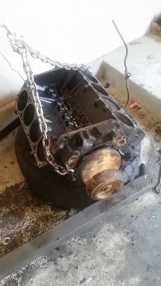

I'm aware of the lower compression in the later model 440s and personally, while it'd be nice to just buy an engine and drop it in, I think where I stand on the subject is about the same. I mean, if you're going through all the trouble to pull your old engine out and put the one you want for your car in its place you should make it worth your time and build it up to where you'd want it to ideally be. With that being said I've decided to pretty much replace the lot, from hardware to valve covers; everything. It's probably gonna run me a pretty penny but that's the price you gotta pay to make it not only fast, but reliable. Me and a buddy of mine went through yesterday and pulled her all apart sans the timing cover, cam, and the crank
because we didn't have a socket or a wrench on hand that fit the bolt, but pretty much everything's scrapped to start anew. Spent a couple hours yesterday planning out the build and what I'd like to do machining wise. I'm thinking bored .30 over with a 4.375in stroke and using forged internals for longevity sake. I'll get around to posting all the details on the parts that are going into it, but for now here's pics of the progress
