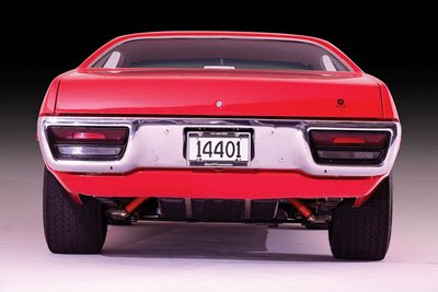

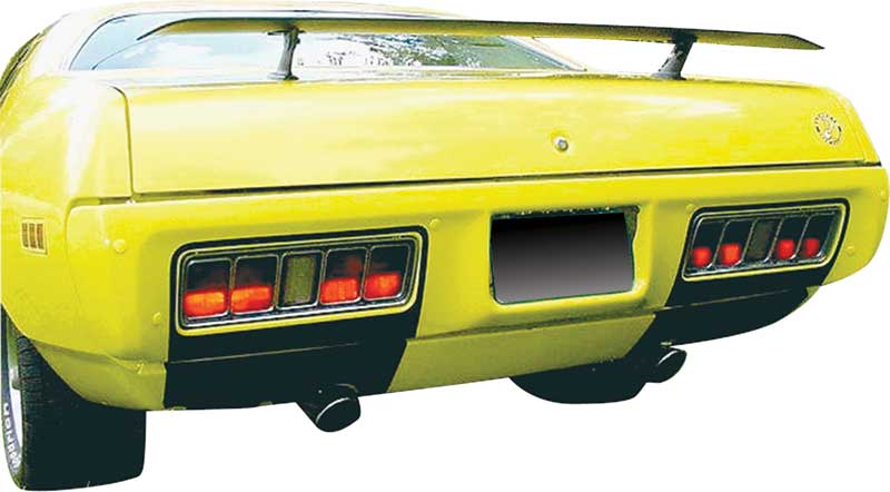

71 Roadrunner Real Valence
Not correct but will bolt on. There will be a big gap under the center of the bumper. 71 bumpers are flat across the bottom while the 72's have a rise in the middle similiar to the front bumper...
QuickBpbp is right, but if you go with a 71 bumper, tailinghts and brackets as well, the whole assembly will interchange.
