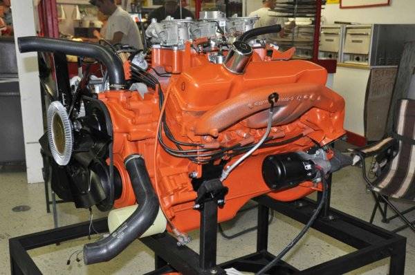

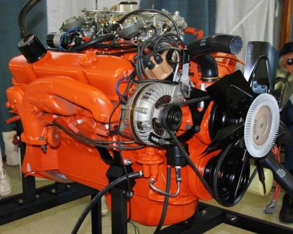

I just bought a set of wire that are supposed to fit 71 383 factory location. 6 of the spark plug ends are 90deg. and 2 are almost straight. The wires on car are 8 90deg. spark plug ends. What cylinders do the straight ends go to? Pictures of engine with factory wire routing would be great if you have them.

Hmmm here are reference pics on a 69....my 68 is the same. The one wire with the straight boot goes on the back passenger side plug from what I can see. I thought maybe the straight ones went where the heat sheilds were on the manifolds, but in these pics even they are 90 degree. I know different year but its all I could come up with right at the moment.
Thanks for the pictures. I have not found a picture with straight wires so far. Still looking.

That one on the rear of passenger side is almost straight but it gets bent for heat sheild. My 68 Runner has the same wire on that plug bank. I am unsure where the other goes.
