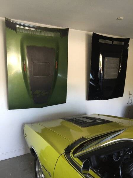

What would this hood be called. It came on a 71 super bee.
Cool thank you .I though at first that was a dume question. And thankx for all of the other good information.it helps a lot

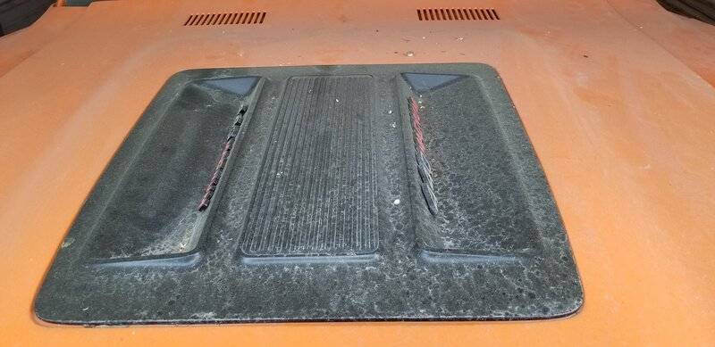

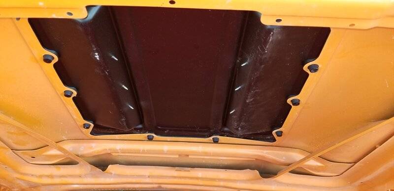

Does this insert have a gasket that went in between the hood and the insert ? Are just insert to hood.

Was the louvered hood an option on the 71 super bee?
R/T Louvered Insert was not an option on the 71 SuperBee - However with the standard hoods being the same , the inserts where easily interchangeable
Adding for reference....71 Bee hood
