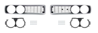

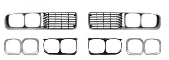

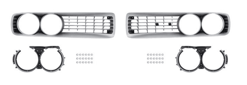

How close dimension wise is the 72 grill to the 74 grill? I know the hole for the lights on the 72 are round. In other words will the 72 grill fit the opening of a 74 grill? Thanks
I put 71 grills in my 74 with very little effort.
IIRC there were two screws per side that didn't line up with holes.
I simply left them out.
72's will fit just fine with at least 2 of the holes aligning on each. You can always make tabs(drill new holes on the tabs) for the other 2 holes and with JB Weld attache 2 nuts and screw in the grill screws.
Or get the grill brackets for them. I think is just the outer ones as far I recall. Inners gets 4 holes provisions each so I guess is just about change the nylon inserts to match?
About drill the holes... good idea, but the inserts could be fitted too, just using a file to get holes squared and install the inserts for the screws like originally are.
Aside that I guess the only diff after this could be the headlights fitting deeper into the grill opening for them, due the larger gap between body and bumper for the fillers.
