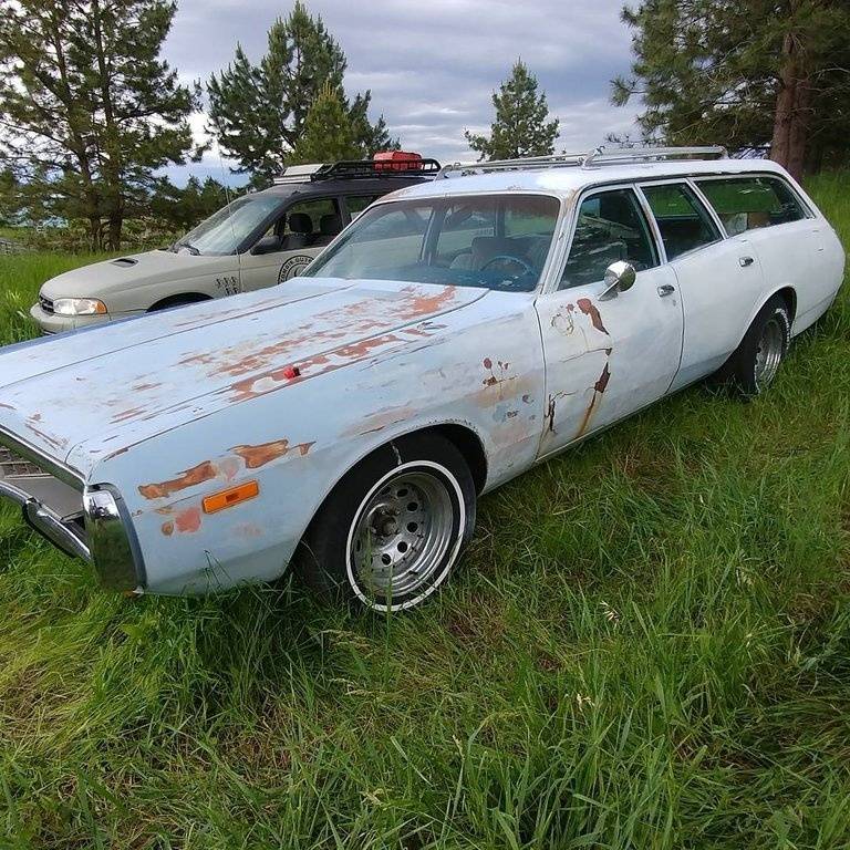

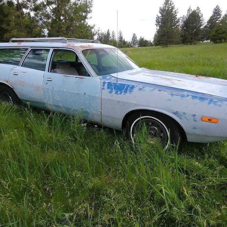

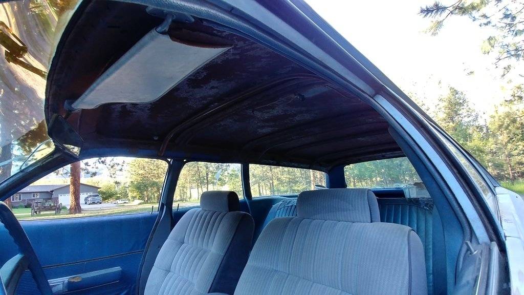

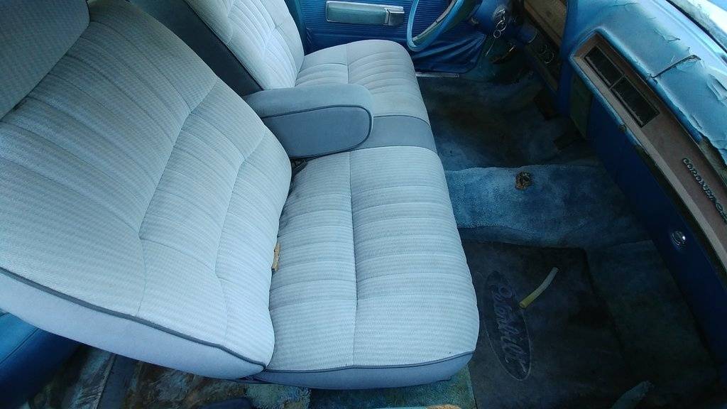

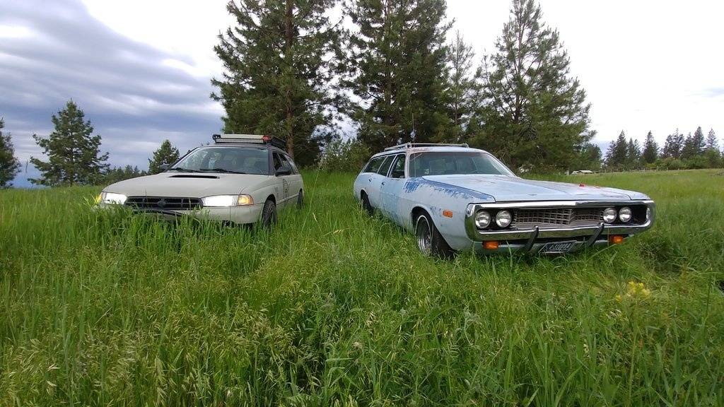

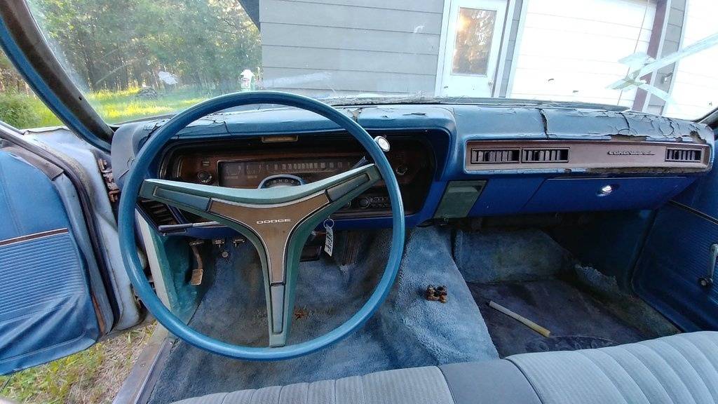

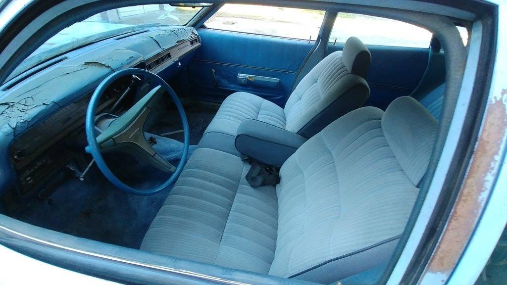

I recently procured a 1972 Dodge Coronet custom station wagon. has a nice little 318, front disks, power steering and brakes and factory A/C. The plan here is to concentrate first on making some decent power in the form of a turbo :). Then work on suspension and interior, and lastly the exterior. Here are a few pics to hook you.

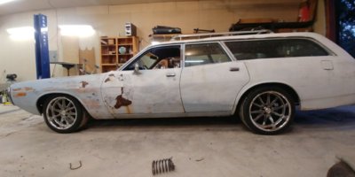

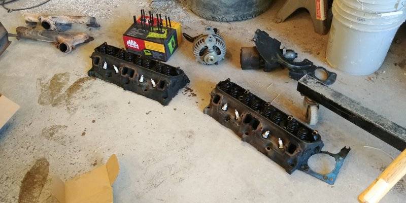

So its been about 8 months since i last worked on the wagon, and have since changed direction with it a little bit. I am still doing a full top end rebuild, already got my 360 heads rebuilt with Hughes Engines performance springs, still doing the RPM Air Gap intake, but now going with an Edelbrock 650 AVS2 carb and will NOT be going turbo. I plan on making it a strong runner and putting her up for sale. I've also gathered up Patriot headers, a Mancini Racing Kick-down Cable kit, and Powermaster Mini Starter to go along with the MOPAR double roller timing kit, and Hughes Whiplash cam.

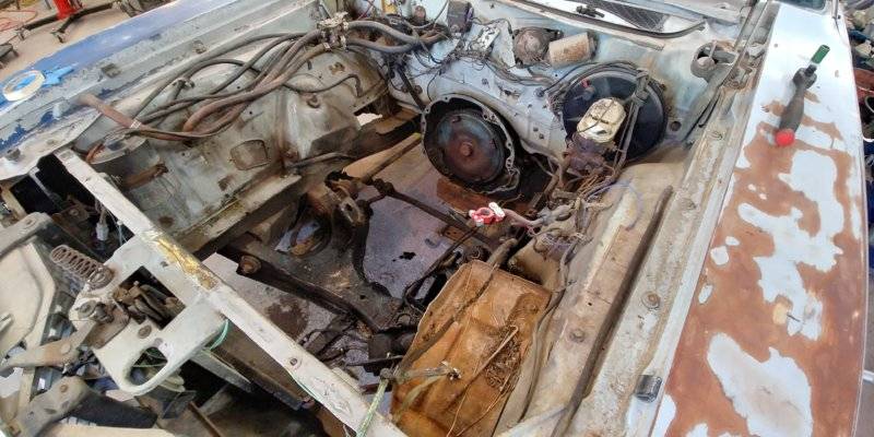

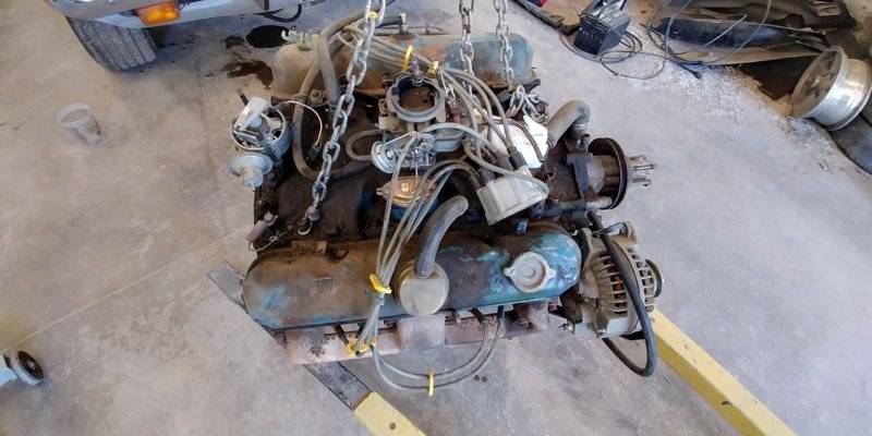

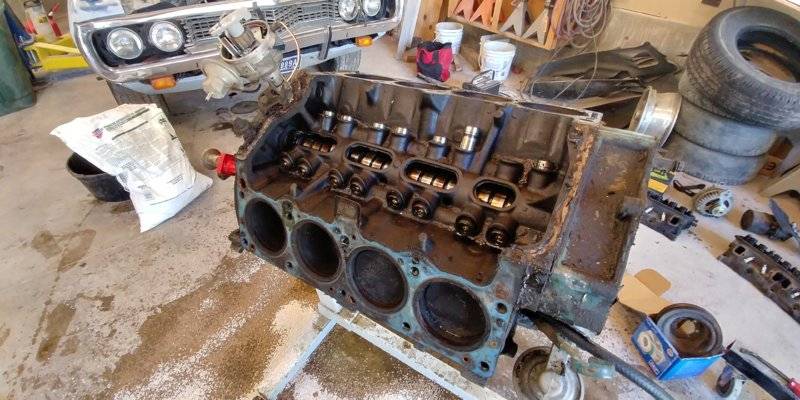

Got it up on the lift last Saturday and pulled the motor, tore it down and ran into a bit of a problem.

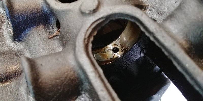

2 of my cam bearings are total junk. Is replacing these going to be a pain in the butt because they are missing so much surface area? Do i need to replace my bottom end now too? oil pump? There wasn't much metal in the pan, most of the large chunks were in the valley. This was supposed to be a "cheap" build so i can make a little profit on this car when i sell it...
Here you can see the bad bearing.
Cam bearings are cheap. I would be a little worried about the cam journal being shot.
Im pulling the bottom end and taking it in to the machine shop for new bearings and a hot tank. Then new rod and main bearings and rings. If there is a problem with the cam journal they will be able to catch it.

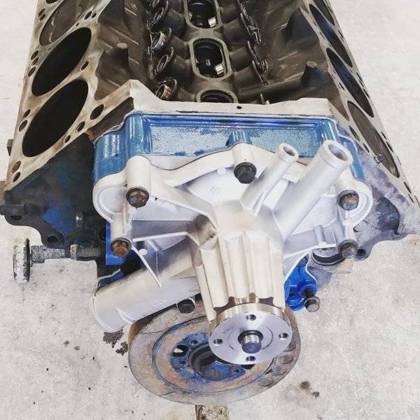

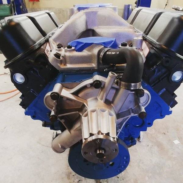

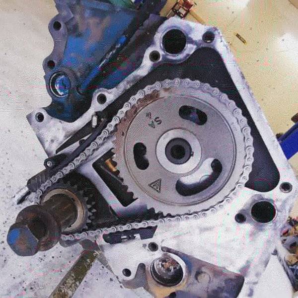

Its been a while so I'll catch you up on whats happening. Finally got around to pulling the bottom end and sending the block to the machine shop for bearings, a hone and hot tank. They called me a day later to let me know that the block i pulled was indeed a 273 NOT a 318! They measured the bore's and found them to be small. I never looked closely at any of the stamping on the block so that was a fun little moment of "zen". After an hour of swearing at myself I managed to procure a complete 318 from a 78 truck for 100 bucks, he even pulled it for me and delivered it at that price. So, i spent a few days last week tearing down, cleaning and rebuilding the top end of the 318.
IMG_20180826_134522_588.jpg IMG_20180826_134522_587.jpg IMG_20180826_134522_586.jpg IMG_20180826_134522_583.jpg 20180825_191814_HDR.jpg

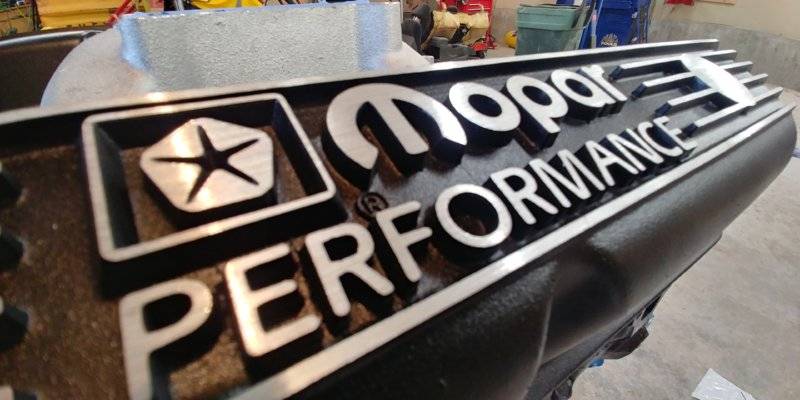

Getting ready to break in this new camshaft tonight. Any pointers?

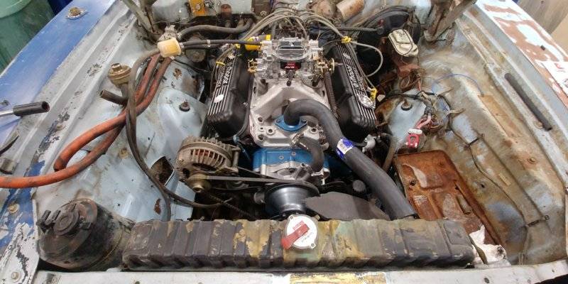

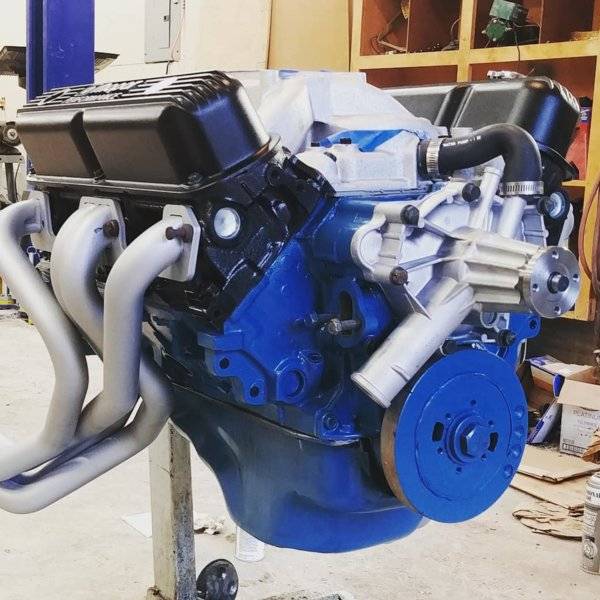

Got it running! I've since installed mufflers from a Hellcat to somewhat stifle the noise. This is with open headers and not much tuning.
