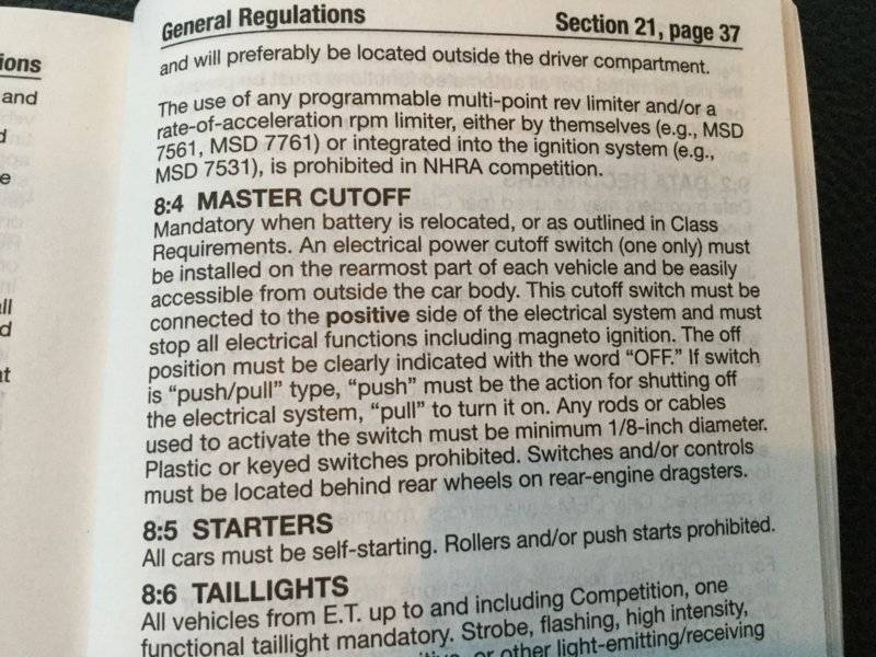

I can’t speak for other organizations, however the NHRA requires that all “kill switches” now be push off. As I understand it a simple throw switch like sold at TSC or other places is no longer acceptable.

I think, but don't know for sure, that rule is for push/pull swiches, so that push is always off. I think the lever switches are still legal. I sure see a lot of them at my local track.
Edit; if i'm wrong , it wont be the first time today!

I just got the NHRA rule book in the mail yesterday so I’ll peruse it and see if I can determine the rule for sure. I replaced a lever switch with a push/pull because I was told “all kill switches must be push off”
Possible that is bad info, however my switch was 20 years old and had been exposed to the elements and was in need of being replaced.
I have one car with a push/pull design, and another with an old lever style, where access is seriously poor. I wouldn't be happy if i have to replace it for no reason other than a new rule.

The info I received was apparently incorrect, lever switches are still legal.
