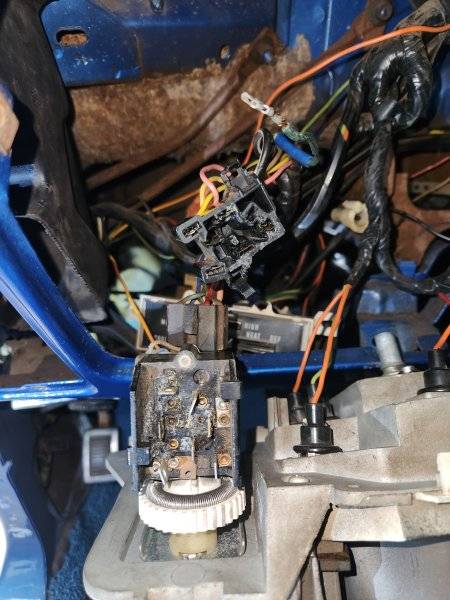

Well at some point my headlight switch and connector melted.
Looking to replace place both could anyone recommend a good source for the switch and 7 pin connector?

I checked classic industries and could not find the part. When searching else where all I can find is 9 pin connectors. Maybe I'm using the wrong search name? - "Dodge 7 pin headlight connector"
Looks like the previous owner "repaired" it by putting in a new green wire as shown in the picture. Any thoughts on what else to check?

The plug was burned up before I even got the car as you can see previous owner rewired only the plug for the hideaway headlight doors.
Replaced the connector, switch and high beam switch/connector.
