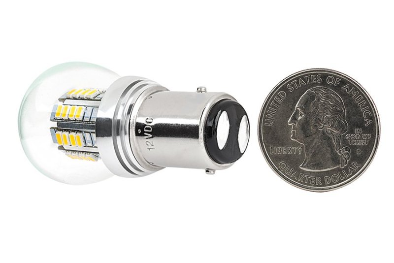

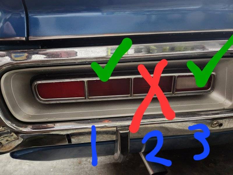

I am looking to convert my taillights to led. I ordered my bulbs from Superbrightleds and the bulbs work for the 1st light and for the reverse lights but the center light does not work.
The bulbs I ordered were these, which work in bulb location 1 and flash when i use the turn signals. When in put the incandescent bulb in the center it still works.
Could someone recommend another bulb from Superbrightleds that would work?
1157 LED Bulb with Stock Cover - 2 Pack

Yeah I tried swapping the led bulb that worked in socket 1, but wouldn't work in socket 2.
Looks like the bulbs only seat one way since the pins on the side are at different heights.
Yes they only go one way. Just make sure the connection in that socket is clean is the only advice for the current bulb.
Old sockets could be finicky with age. Maybe order up a different brand 1157 and try those, at least from amazon if they don't work, return em until you find ones that do.
yeah I’ll try some other LED 1157s.
But it’s weird all the other incandescent bulbs work just fine in this one socket, just the LEDs won’t work.

The center socket works with the original incandescent bulb, but not the LED. So could it still be a ground issue? I guess are the LEDs more sensitive to ground issues vs incandescent?
They can be. Are the bases solid like the incandescent bulb. Some LEDs have soft metal bases or pins that are not strong enough.
Have the contacts on the socket sink in to the plastic piece holding them? It looks like the contacts on the LED are longer/wide than they are on a conventional bulb
These would have a better chance of hitting the contacts if they are recessed then the ones you have
LED voltage only flows one way. Check the wiring. It could be wired backward since the stock lightbulb only needed a ground.
Okay I'll check the wires. What would be the correct way?
Not 100%true
A lot of the bulbs have no polarity preference.
The wires should be fine. Easy test take a volt meter put the negative against the side of the socket and positive on the bottom with lights on should be 12 volts.

Curious why the ones you linked are better? Comparing to what I have they look the same and don't even really show what the base pins look like.
What I bought.
1157 LED Bulb with Stock Cover - Dual Function 36 SMD LED Tower - BAY15D Bulb

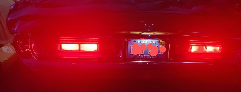

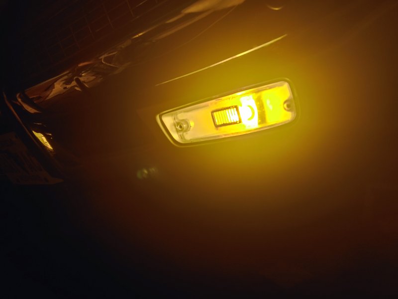

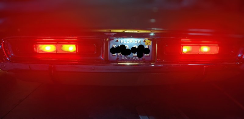

Just took pictures of my car with lights and brakes on. My license plate light is also LED
