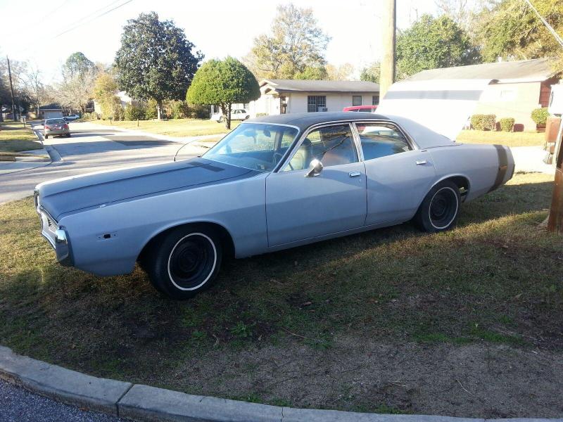

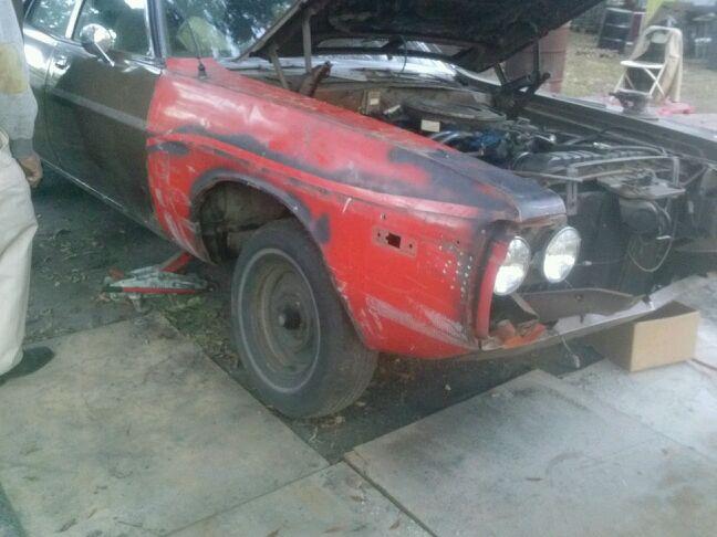

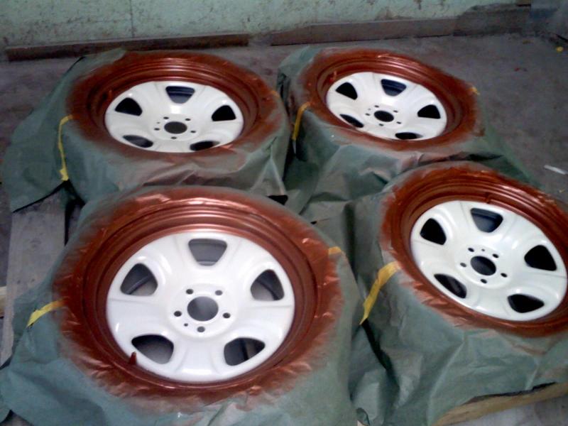

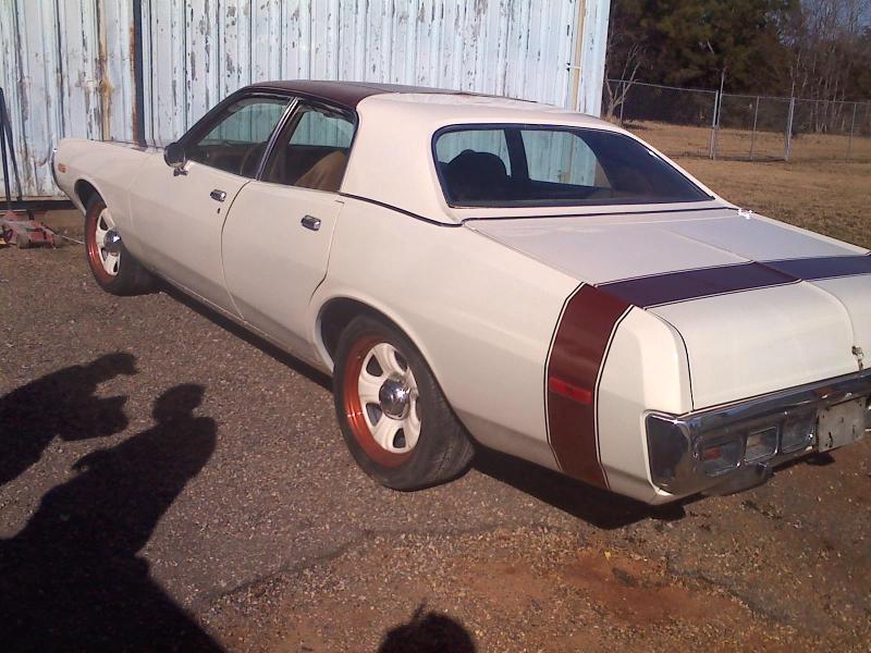

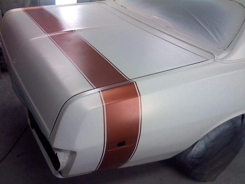

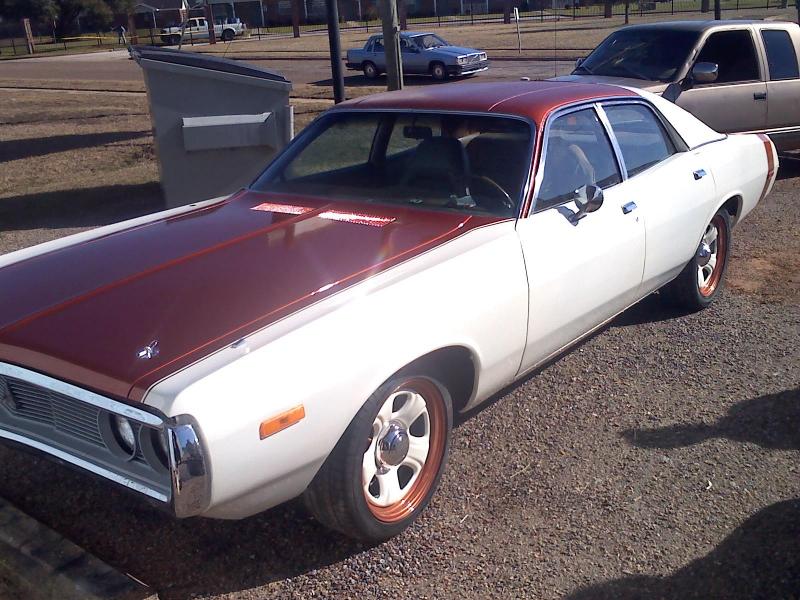

I would LIKE to thank everyone for their help with my 17 yr. Old kid first (mopar) car. We hit the ground running with this 72 coronet custom 29k miles (318)... In a relatives yard in southern alabama. We are in ohio,car in ala., pass. Fender from portland or. Junkyard,front bumper from la calf.,grill from fla & advice from mopar folks all over the u.s. It may not be up to the liking of some people...but it is his...most important it brought us closer...father & son..all in time for mardi gras...thanks d creoles...burnt orange & cream pearl...charger cop rims(no my choose to two tone them)

Looks good. I've been looking for a passenger fender for my 72. Where you find yours

Question: How do the late model Charger steelies fit? Any spacers or bolt pattern wizardry going on there? They're 17"s correct?
The rims are 5x4.5 just like the original rims, no spacers, no slack...there is enough room to take out 1 leaf from the rear springs & lower the front...torsion bar lowering =caster concern ...change control arms..the guy in Japan was a lot of help, read this article (search bing) [h=1]1972 Dodge Coronet - No Gaijin Car craft magazine[/h]
