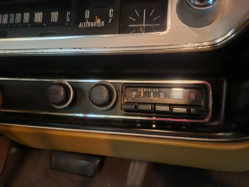

My wagon has a good working AM radio in it. I'd like to upgrade that to an AM/FM version. I've found a couple of units on Ebay that look right, but I don't know if they will fit or not. I'm no B-body guru but I'm guessing AM/FM was an option back in the day. Here is what my radio looks like:
Does anyone have a factory AM/FM unit that could post a photo or two? I'd like to see how it appears in the dash.

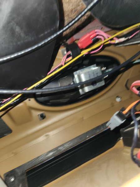

The next question is, what size speaker is in the dash? I have a single one that looks to be a 4x10 but it's hard to get at to measure.
Don't know why it wouldn't be available in a Coronet. Was an option for 71-4 B's. I have one in my Satellite.
Post a link of the radios that your looking at.
I think the speaker is a 4x7
