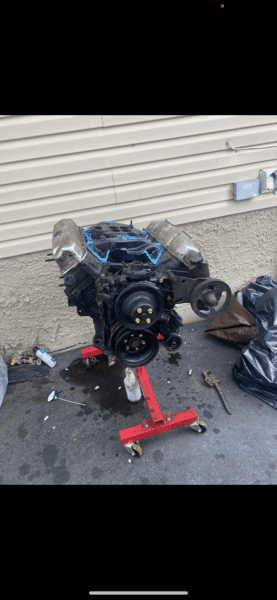

So I'm swapping my 72's 318 for a 383 from a late 60's road runner. i got the engine for 300 bux so far I cleaned the heads put new gaskets on, man was this thing a sludge bucket!.
My question is can I use the 318 alternator, fuel pump. and what other parts can i steal from the 318 i just ordered mounts and need to get a new carb and headers. distributer timing is also a thing I'm gonna need help with more or less setting the firing order and how to go about it. I am mechanically inclined which is good but any advice would be greatly appreciated tryna do a sleeper with a hemi hood scoop ; ).
If you have all the brackets for the 383, and that is it on the stand in the pic, it's pretty easy to find out if the front accessories will bolt on. I can't say on the fuel pump.

You can use:
alternator, but none of the brackets
starter
water neck and thermostat
distributor cap and rotor only.
other than that you need BB parts.
you need a different transmission for the 383 also.

got the trans hopefully it works

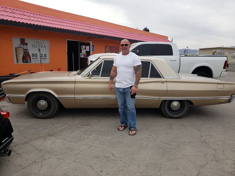

Here's a sleeper, 383 stroked to 496, 610hp/670tq at crank.
Nothing at all is wrong w a 383. I actually love them. I was saying a 383 under the hood of a Hemi scoop is not a sleeper. Since you were making a joke, then it's not relevant.
thats a beautiful coronet WOW!!! min was an nypd car form the 70's
Thank you. It was my Great Grandmother's, she bought it new in '67. I inherited it. 95k original miles now and a desert car always garaged.
